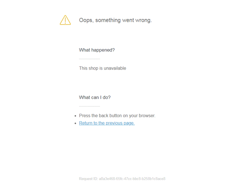

Beings though the link you provided is now not available may answer some questions
