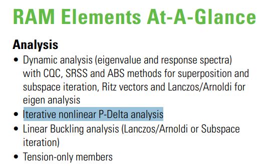

I am using RAM Elements which only just recently added the linear buckling analysis feature. To my knowledge there is no capability to capture geometric non linearity effects.
Forgive me for being annoying but I still think that your software likely is capable of doing a geometric, non-linear analysis. I suspect that it's the option that I've highlighted below. Hopefully someone here with more RAM Elements experience can confirm. Alternately, a quick call to tech support or some example testing could confirm this. The stuff below doesn't explicity mention geometrical non-linearity but, given how easy it is to add that in programatically, I'd be astonished if it's not there.
