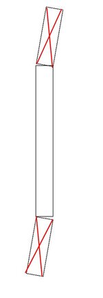

I have a series of wood trusses terminating on the interior of the building which have some very tall heels (13'+)
There is no shear transfer by design here - although some might occur in reality.
I'm leaning towards sheathing this section full height, but am wondering if that might be overkill - in lieu of X-bracing.
(truss profile is hatched in figure below)

OP started this thread by proposing sheathing the truss verticals over the interior bearing, specifically not for VLFRS. And several of our friends here have expressed support for that. Is sheathing that surface not functionally identical to installing full height blocking? I feel that it is.
I agree with you here, and was trying to make that exact point. The sheathing in OP is similar to blocking at interior bearing, yet I would imagine that few of those who expressed support for the sheathing would also be in favor of blocking at interior supports (but could be wrong).
Personally, I do not feel like the sheathing is needed, nor blocking at interior bearings (provided adequate chord/web bracing are provided) unless part of LFRS.
Are there any other meaningful examples of deep wood framed members that either do require some sort of "rollover" or torsional bracing @ bearing, or do not that come to mind?
The most common one that I know of is so close to OP's case as to, probably, be uninteresting. Light frame unit/corridor setups. Here, full depth blocking is usually considered impractical. So you're relying on lateral restraint of the bottom chord coming from the corridor wall top plates. Those, in turn, are themselves laterally restrained by the corridor walls -- intentionally or incidentally -- behaving as shear walls.
Another example is floor trusses at interior supports (multi-span, not continuous). There you will typically just have the ribbon which, in my opinion, is only there for vertical load distribution, not rollover resistance (no doubt it provides some).
I've looked at a number of wood beam over girder industrial building where the beams were set up Gerber style with no rollover bracing. This is kind of ambiguous though because the beams are usually so stocky that they probably benefit from pretty decent "bracing" just by virtue of their own geometry.

There's still a little life left in this horse, at least for me - not sure about the OP, but I've been meaning to get back to it.
3) My hunch is that the "lateral restraint" bit eliminated from the NDS was originally expressed as it was precisely because they were assuming that most members have automatic lateral restraint at the bottom coming from the sheathed walls that support them. Where that is true, top restraint = rotational restraint. But, then, assumptions are dangerous so it's best to avoid them if you're a code writer.
The statement from the commentary says that "lateral displacement does not necessarily prevent rotation". If they were assuming there was not a VLFRS capable of providing the required stability, then prevention of lateral displacement also wouldn't be provided. But then, they must be getting at something else...

The blocking I was referring to is truss blocking between trussed at interior bearing (No LFRS). Lets say a 50' span truss @ 8:12 with a bearing right at midspan. Are you planning on 16'-8" tall x 2' blocking panels between each truss? That may be a big ask, and not commonplace in my experience.
@RWW0002 so you are in support for blocking conventional framing at interior bearing (not shear) walls? If so, why wouldn't you support doing that for a trussed system? Don't say the lever arm....:ROFLMAO:
I agree. Through this discussion, I have settled on solid blocking matching the chord depth at top and bottom in addition to proper CLBs for the webs, this I feel addresses the concerns I have and any exorbitant expense. This of course isn't my project, so no idea what @struct_eeyore has/will do.

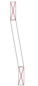

So you do not trust the moment connection shown below then? I've not shown any eccentricities but acknowledge their presence.
In this sense, it is the OOP flexural stiffness of the truss web that rotationally braces the chord.
I have some measure of sympathy for that approach at the truss bearing (bottom). I would argue that it is not a rational approach at the truss top chord however.
From a stability perspective, I fail to see how the condition is any different at the end web joint of the truss top chord than it is at any other web joint along the truss top chord. And surely you are not proposing such blocking at all of the top chord panel points?
