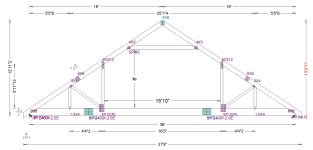

XR250 - I'm going to attempt to post a design based on what you asked. Since the forum software is different, I don't know how it will go.
test
test2
In your post you said something about a 2X6 BC working. Surely you didn't mean that? It's not even close to being possible.
I made the room 15' 10" rather than 16' 0". That way the narrower face of T&G plywood will work out, and they won't have a narrow strip to fill in.
I used a 2X12 BC so the span/depth ratio is less than 18.
We don't do a lot of 8/12 attics. The forces in the TC are high enough I went with 2X8. Lots of bending at the wall vertical and collar tie.
You'll notice there's no kingpost above the collar tie.
This is how I'd send this truss to the plant to be built. Others would do things differently.
Ron,
Thanks for running this. The idea was to run it with a center bearing to see how that affected bottom chord size and also how the support reactions at the ends changed. Can you re-run it with a center bearing? Thanks
I'm curious, do the newer truss design software iterations handle these bending moment regions? (One would be tempted to presume given the program outputs something, but I'll ask anyway), as trusses go, this one isn't strictly a truss.
Ron,
I didn't get that from your post. I'll see if I can do it today.
Not sure what you mean by "these regions".
Attic trusses are obviously not fully triangulated. There are high bending moments at the TC joints - Especially on low sloped attic trusses.
The program we use has been developed over the past ~30 years, and is used nationwide. They wouldn't seal attic truss designs if they weren't done right.
