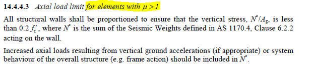

Does clause 14.4.4.3 - Axial load limit for elements with u > 1 that are limited/moderately ductile play any role in this determination? The clause appears to imply that if the stress under G+0.3Q in any wall/column exceeds 0.2fc', you cannot proceed based on the limited/moderately ductile assumption and will need to design the wall/column element in question as non-ductile for the full elastic earthquake load. What are your thoughts on this?

Structural wall definition is in 14.2.10. It is very specific. Basically any wall connected to the floor diaphragms that attract horizontal earthquake or wind action.
The clause is simply controlling the wall dimensions for "All Structural Walls" based on the defined loading. A structural wall, whether it be ductile, limited ductile, non-ductile, if it is structural, the axial load stress is limited to this value.

rapt, the clause does not appear to concern non-ductile walls though, as it only relates to elements with a ductility factor of greater than 1.
Also, if this clause relates to all structural walls (including columns), it will be very difficult to satisfy this clause for the majority of columns given that they will be attracting very high axial load at the outset due to gravity (even under the seismic weight given by G+0.3Q).

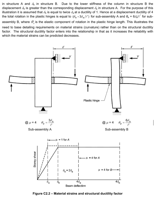

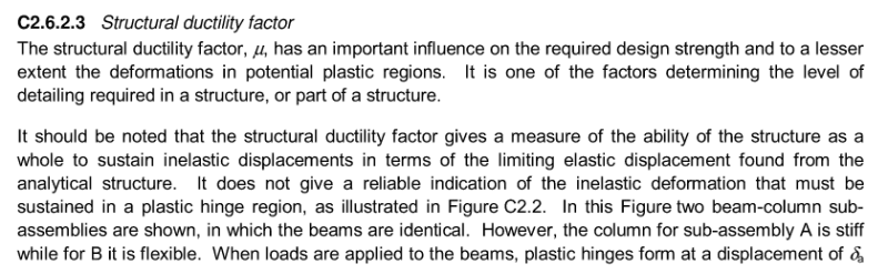

You may not be recognising that even under mu = 1 global actions, the local ductility demand (i.e. curvature) in certain elements may exceed the limits afforded to ductile detailing limits. I'm just not sure how AS3600 addresses the limits side of things, whether the driver is a curvature limit or otherwise for tipping you into the various detailing requirements. I hope its not based on the global ductility as that mu>1 seems to imply as its an incorrect approach!
This picture from NZS3101 helps explain this concept, that the global ductility for determining the overall loads is independent of the local ductility demand occuring in members. You can for example design for mu=1 for determining the global base shear, but have certain elements that require ductile detailing due to the curvature they are seeing in potential plastic hinge regions.
The reason for the axial load limit is that walls traditionally don't perform that well under higher axial load because the confinement requirement isn't usually as rigourous as for columns.
In NZ for example we have an upper limit on N* of of 0.3 instead of 0.2f'cAg you note. But then traditionally we have always had quite strict confinement criteria when compared to most international standards. If we go over 0.2f'cAg then we need to also ensure the thickness of the wall doesn't make it too slender. Other than that we also have the provision that if you exceed this axial load limit you have the option of designing the wall following the column provisions (which in theory will result in higher levels of confinement).
That makes a lot of sense, however based on my design experience in Australia the global ductility class assumed for the building is used throughout in the design and detailing of the vertical lateral load resisting elements. I am not aware of breaking it up into global and local ductility, and the code certainly does not go into that sort of detail, perhaps due to being located in a region of low seismicity.

Notwithstanding the above however, and referring back to clause 14.4.4.3 re: axial load limits, there are no provisions on detailing if you exceed the 0.2f'c stress limit - its a dead end. So if you have assumed a limited or moderately ductile structure, and designed and detailed the main lateral load resisting elements (core and shear walls) to suit, but a handful of columns happen to exceed the 0.2f'c limit (which is highly likely in almost all scenarios as far as I'm concerned), it appears you will need to revert to a non-ductile system for all elements (not a great result), or increase the size or strength of the columns in question in order to maintain the limited or moderately ductile assumption made initially. I would expect (as you noted) that if you exceed this limit, it would simply tip you into more stringent detailing requirements, but there are currently no provisions like that in this regard.
Clause 14.4.4.3 states that the 0.2f'c limit applies to walls; it does not mention columns. I'm not sure if that means as long as you design the wall using Section 10 of the code you don't have to meet this requirement. I suspect that was not the intent of the authors of the code; however, it's certainly not clear.

The logic is meant to get you to increase the column dimensions until the clause is satisfied! It is an absolute maximum, independent of detailing.
Apparently it has been shown that having too high a pre-compression of a wall limits its ability to behave in-elastically and therefore perform its post-elastic plastic drift. A bit like the more stringent ductility limits for beams which have to have sufficient ductility to allow sufficient plastic rotation to occur after a plastic hinge forms.
As you should not be mixing ductility of elements (as you have discussed above) then you cannot simply say the offending wall is non-ductile if all others are limited ductile or moderately ductile.
Took us 35 years to sort it out (our code up unto 2006 used to be exactly the same), you'll get there eventually to.
But in the interim if that is true with the detailing required being tied to the global ductility then you're certainly doing it incorrectly. It has nothing to do with low seismicity.
