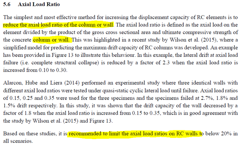

I came across another paper (which I alluded to in an earlier post) which appears to be a precursor to the new earthquake provisions of the code and is titled "RC walls in Australia: seismic design and detailing to AS1170.4 and AS3600".
Rapt, with reference to this paper and going back again to the clause on the axial load limit for structural walls, recall you left off by assuming this limit probably did not apply to columns. Please see below excerpt from the above paper providing some commentary on this, where it initially suggests the axial load limit applies to BOTH walls and columns, however its concluding statement only references walls - I have highlighted these sections for clarity. What are your thoughts on this? Do you still believe this limit would only apply to walls given there will be a higher level of confinement provided by default in columns?

Drapes,
I discussed this with the author of the paper mentioned above, Scott Menegon, before I gave that reply on Jan 24th.
If a column was the dominate stiffness in a sway frame and in single curvature, it may apply to it. If the column were a minor stiffness braced by more dominate walls and in double curvature, it probably does not apply to it.
"If the column were a minor stiffness braced by more dominate walls and in double curvature, it probably does not apply to it."
Does this mean then that there is a point where an elements stiffness can be deemed negligible and the tight EQ requirements wouldn't apply? This is essentially what I've been trying to get some clarity on.
If a long blade column is significantly less stiff than the core box, do the EQ requirements for structural walls still apply?

Further to this, my earlier comment to Drapes only applied to the .2f'c limit in 14.4.4.3!
Thanks RAPT,
Cl 14.4.4.3 does state "All structural walls", and by definition (and what this thread is all about) shouldn't the 0.2f'c apply to all elements, regardless of their relative stiffness?

I thought I answered your first question above. Yes, the code says all walls. Not columns. And yes there is a problem with this if engineers try to game the system by calling a wall a column based on some length to width ratio, which is why I tried (apparently unsuccessfully) to introduce some sensible relative stiffness logic into the discussion to explain why.

CL14.4.4.3 Axial load limit for elements with u>1. The description says N*/Ag, where N* is the sum of the seismic weights defined in AS1170.4 (earthquake code). So, is this axial load limit only for G + 0.3Q?
It says increased axial load resulting from vertical ground accelerations, if appropriate, should be included, which would then only be applicable to Parts and Components in Section 8 of AS1170.4 - so maybe non-load bearing precast walls. EDC 1, 2 & 3 state vertical ground accelerations need not be considered.
But should axial load from horizontal load EQ be included in this? I would think so..
The paper by Scott Menegon and John Wilson, 'RC walls in Australia: design and detailing to AS1170.4 and AS3600, Table 3 states the 0.2 axial load limit for N* is calculated using the load combinations for EQ action in AS1170.0, which would be G + Eu + 0.3Q.
14.4.4.3 says Increased axial loads resulting from...system behaviour of the overall structure (eg frame action) should be included in N*.
I think this might be what you're looking for.
The loading is gravity load based on the seismic weight. The frame effects mentioned are frame effects on distribution of gravity load. This was mentioned to make sure that the effects or transfers and sway effects due to non-symmetrical structure and loading were included.
Horizontal earthquake load is NOT included.
