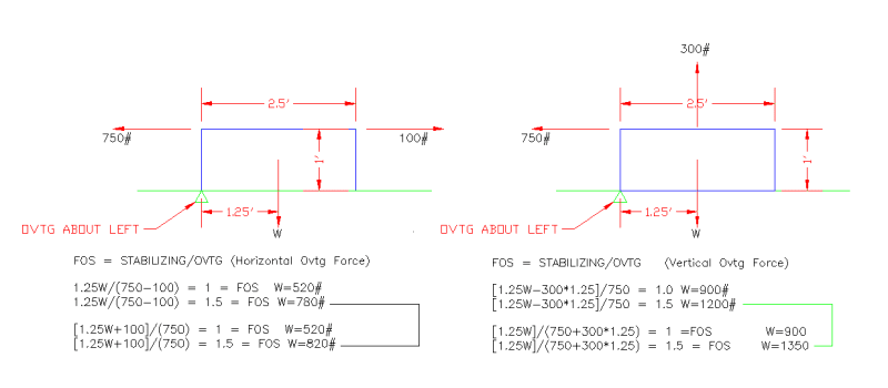

My main question has to do with how you mathematically treat an uplift load when doing overturning calcs. I have seen 2 different ways but they do not yield the same answer. Currently I am reviewing an older structure for new loads but the old design did not calc them the same as I do. Just thought I would see how the Eng-Tips world does it. I have always used all stabilizing forces divided by all destabilizing forces as the formula for FOS. This is definitely the conservative method. I have seen many times where they are treated as net forces and then the FOS is calculated.
The attached drawing shows a fdtn with a horizontal and vertical applied forces. The upper set of calcs is net forces while the lower set is (all stabilizing/all destabilizing). The 2 methods do not matter if the FOS is 1. It only matters when the FOS is not 1.
Just curious how this is treated by others. The more loads and the higher the FOS is, the more the footing weight amount differs.
Also would like a good layman's explanation of how the 300# vertical load can cause overturning about the left and right sides simultaneously. Other than statics says it will. It seems that if the fdnt is not truly attached to the ground on one of the sides, it would only create uplift but not overturning. In that situation, the net force method seems appropriate to some degree.
1.
Mstab = 1.25W +100​
Mot = 750​
FOS = Mstab/Mot = (1.25W + 100)/750​
Alternatively, W = (750*FOS -100)/1.25​
if FOS = 1, W = (750-100)/1.25 = 520​
if FOS = 1.5, W = (1.5*750 - 100)/1.25 = 820​
2.
Mstab = 1.25W​
Mot = 300*1.25 +750​
FOS = Mstab/Mot = 1.25W/(300*1.25 + 750)​
Or W = FOS(300*1.25 + 750)/1.25​
if FOS = 1, W = 900​
if FOS = 1.5, W = 1350​

If the 750# horizontal force is removed, then Mstab = 1.25W and Mot = 1.25*300
FOS = 1.25W/1.25*300 or W/300, hence W = 300*FOS
if FOS = 1.0, W = 300, and the footing is just balanced. There is no net uplift and zero pressure along the bottom of footing. The footing is just floating in space.
if FOS = 1.5, W = 450#, so the 300# uplift created pure uplift and no overturning, but the factor of safety is against liftoff rather than overturning.

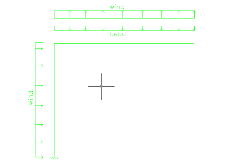

Josh: I am not sure what you are stating. I assume by gravity loads you mean all gravity loads, not the footing weight. There are instances where the gravity loads destabilize the same as wind load. One example is a lumber shed that has a fixed base column and a rafter as depicted below. In that example, I cannot separate the forces (Fy,Fx, Mz) by load case because Mz could be the same sign for DL+WL if I make the shed tall with a short rafter as compared to short with a long rafter. I tend to draw all loads regardless of load case source and then choose the stabilizing and destabilizing.

Two cases for your example:
1) If you're looking at your WL + DL case, then the true safety factor method will still be correct. Either for a wind uplift or a wind downward load.... with the idea being the safety factor should represent the multiplier on the destabilizing load (WL) that would cause instability.
2) For a dead load only case, proper way to do this would be to separate this load into two parts... The stabilizing part and the overturning part. The most common case that I saw (when working on petrochem projects) was a vertical vessel with a re-boiler that hung off of one side. In that case, the weight of the main vessel would all be considered stabilizing, but the weight (and resulting moment) of the re-boiler would both be considered de-stabilizing. That way, the Safety Factor would be how much you could multiple the Re-Boiler by before the footing becomes unstable. It wouldn't work out that way if you considered the weight of the re-boiler to be a stabilizing effect.
The case you show, where the ONLY dead load has a de-stabilizing effect is the one case where the true safety factor method breaks down. In that case, it makes sense to revert to the traditional method (combine all axial forces together to come up with a stabilizing effect and combine all the moment together to come up with a de-stabilizing effect).
