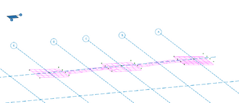

I'm having trouble understanding how the grade beam can resist all the overturning moment. I've tried modeling footings and grade beams as a matt slab, and I can see how it is providing some restraint. However, I don't think it is right to assume the grade beam completely resists overturning. From my matt slab model, I can see that the "footing" is rotating and not acting like a true fixed end condition. I believe this would make my grade beam to have a pinned end condition instead. Because of this, my footing is not acting like a true fixed condition and is allowed to rotate.

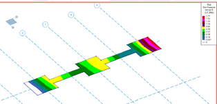

So the grade beams provide overturning resistance and prevent the individual footings from overturning, correct? However, there would still be rotation in the footings, and that rotation would depend on my grade beam stiffness. From my FEM matt slab in Risa, I can see that the soil bearing pressure is greater on one side of the footings which I believe is coming from that rotation. Should that be expected and would stiffer grade beams help reduce that? 1745959878904.png1745959846670.png
Yes the stiffer you make the grade beam the less rotation at each footing you should see.
If it was infinitely stiff you would see rigid body rotation of all three footings that is a function of the loads and the spring stiffness assigned to the soil.
