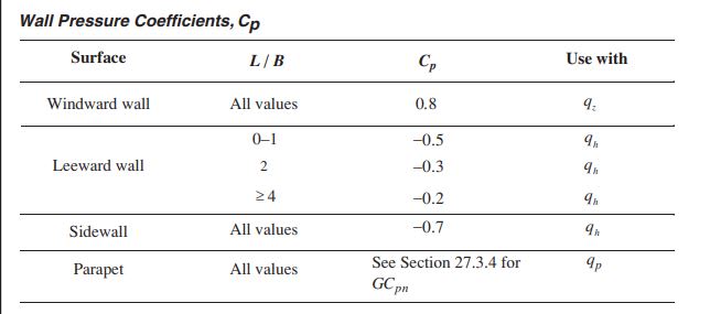

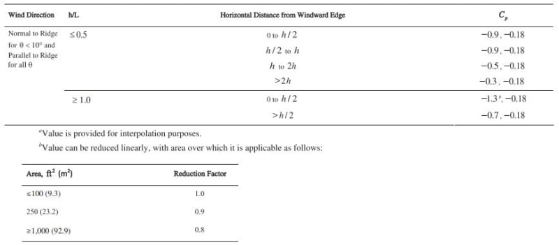

All the loads should be considered simultaneously for stability check. If it enclosed, with flat roof, will develop negative pressure. ASCE 7 gives leeward coefficients as a function of length to width, and roof pressure as a function of height to length (the length is parallel to the wind direction under consideration). See screenshots for the coefficients.
Notice, the maximum value coincide with what you mentioned (0.8 + 0.5).
For roof

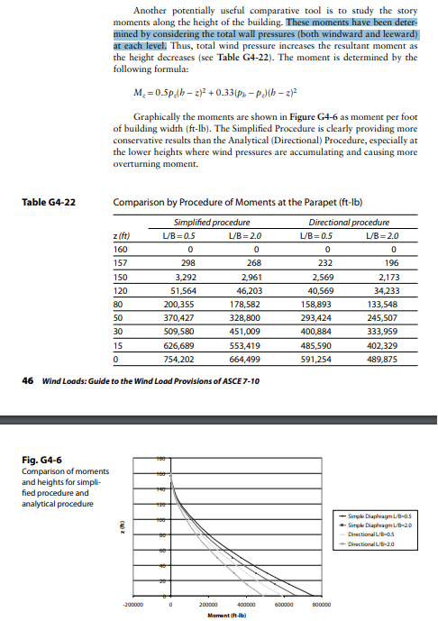

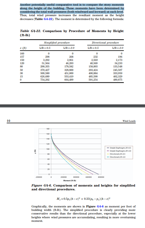

I'm not familiar with ASCE requirements and version changes but i did find this guidance doc from ASCE press for ASCE-7-10 that only considers windward and leeward pressures for overturning moment of buildings, which is consistent with JStephen saying that any contributions to OTM by roof suction was ignored in earlier versions.
edit :
I also found the same doc for ASCE-7-16 and the approach that example does not include roof suction in overturining for buildings even if it does for vertical tanks as JStephen says.

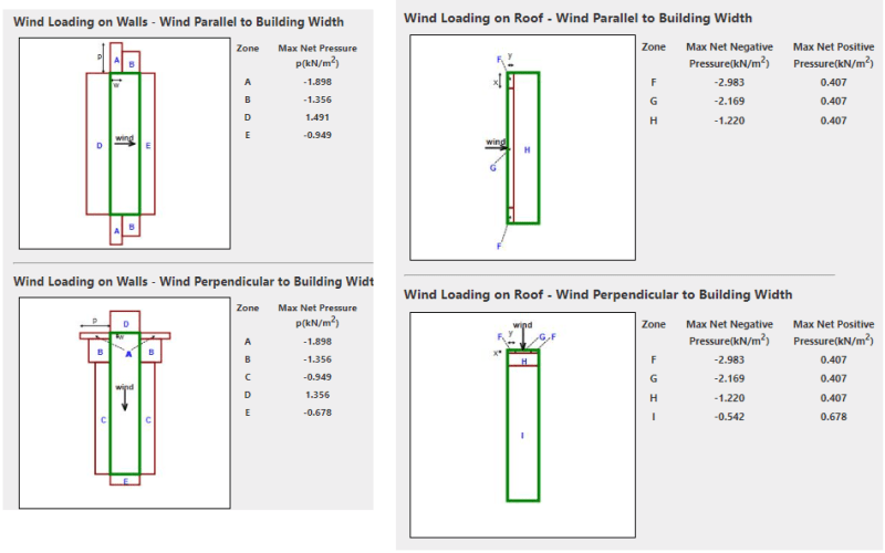

For clarity, here is some examples from online calculators that match with my understanding of wind suctions and zones for a 12m x 2.5m x 2.5 m shipping container. The final values differ due to different pressure/suction coefficients chosen.
and more detailed version of another online calculator for walls and roof
[URL unfurl="true"]https://res.cloudinary.com/engineering-com/image/upload/v1729850035/tips/Calculation_of_wind_pressure_loads_-_Eurocode_1-_ShippingContainerRoof_ichoem.pdf[/url]
[URL unfurl="true"]https://res.cloudinary.com/engineering-com/image/upload/v1729851645/tips/Calculation_of_wind_pressure_loads_-_Eurocode_1-_ShippingContainerWalls_peqgxr.pdf[/url]
