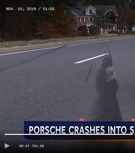

This shows the skid marks and path of the vehicle:
Sucks for the passenger and his family. Darwin award for the driver.
I think it flipped. The marks are too far apart to be a frontal skid or loop.
It's just hit the kerb and gone airborne rolling over.

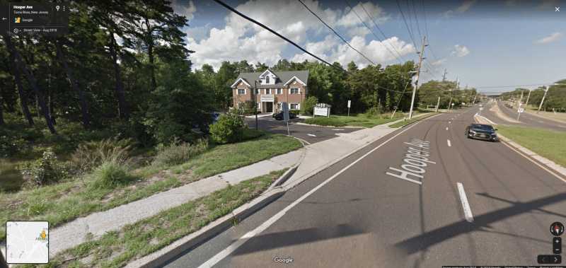

Can't see this going 160 - Not really enough distance to get to that sort of speed. - Google map 1466 Hooper Avenue, Toms River, New Jersey, USA
I was skeptical about the speed too. I live right by there, I drive that road. As soon as you get past the mall, and if you are willing to blow the traffic lights, you've got just under a mile of fairly straight road to let loose. I don't know if 160 is realistic, but you could definitely get well over a hundred in the right car on that stretch.
