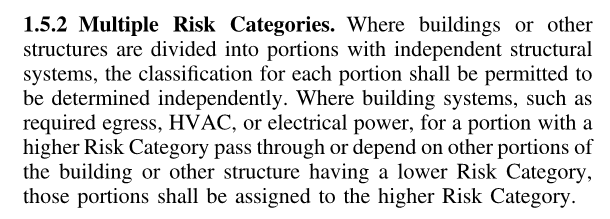

Clause 1.5.2 of ASCE 7 basically says if there is something category III in the building, even part of it, then the entire thing is to be classified as category III. (I'm not from the states but I assume this is what you are working to)
What are the exact wording that classifies the podium as III, maybe there is some leeway there?
Thanks Agent, I've reviewed the relevant ASCE 7 clauses and commentary, it's pretty clear that, taken at face value, it would require the entire structure with a single category unless structurally separated. And yet I know of two examples where this hasn't been followed. The thing about PBD is we get to essentially write our own code (design criteria) as long as we can convince the peer review panel. So I am trying to determine the reasoning why it was acceptable for these past examples.

I suspect that you'll struggle to sell different risk categories stacked vertically, particularly with the higher risk category being at the bottom. Where the spacial separation between risk categories is horizontal, that makes more sense to me. Especially if the following are true which, often, I'm sure is the case:
1) The two occupancies have independent lateral systems above the podium and;
2) The two occupancies have independent egress through the podium.

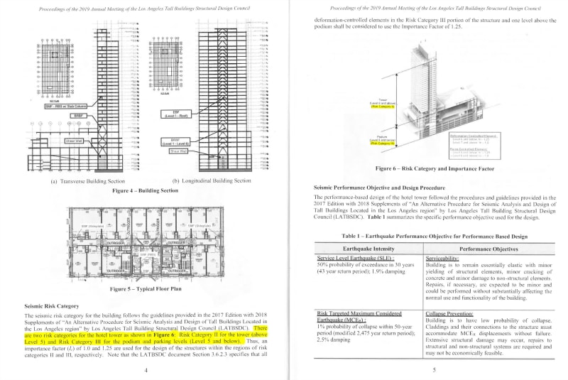

Koot, one example was two towers on a shared above-grade podium, the other example is that building I posted above, which is a single tower with 5 story podium. In my project, there is a separate bank of elevators that exclusively service the office.
I was thinking about this scenario similar to jayrod's interpretation. The entire building is designed for Risk III demands from foundation to top of podium (including our code-based design and MCE collapse-prevention assessment). In fact, we could do the entire code-based design for Risk Cat III, it doesn't really matter. My main objective for this is that I don't want to arbitrarily increase the demands coming from the nonlinear collapse-prevention analysis by Ie=1.25 for the upper tower portion of the building (or reduce the deformation capacities of nonlinear elements by 1/Ie).
I think this makes sense, intuitively. It's of little consequence to the office below that some coupling beams or slab outriggers in the tower went to 6% rotations instead of 5%, or that the tower drifted 3% instead of 2.4%. We aren't designing a post disaster facility - there is no expectation of damage-free performance.

I'm going to be sneaky and summon Deker and Sandman21 over to this thread. They're both LA guys and would be perfect for this.
The large towers I know had the same risk category, III in the couple cases I know about. But the lower portion was designed as ELF and tower as PBD, creating two systems. The 2017 LATBSDC section 3.6.3.2.3 seems to cover your condition, "Where multiple towers on a common podium or base create a situation in which the number of occupants at or below the podium or ground level may exceed 5,000 persons, then the value of Ie = 1.25 shall be used in conjunction with application of Equations 5a, 5b, 6a, and 6b for all force-controlled actions including those of the podium diaphragm and below, including the foundations placed under the Risk Category III portion of the structure and all force-controlled elements of the tower passing through the Risk Category III portion of the project. Acceptance criterion for all deformation-controlled elements of the tower passing through the Risk Category III portion of the project as well as all deformation-controlled actions of the first level of each tower immediately above the common podium shall be considered as 1/Ie times the acceptance limit for a similarly situated the Risk Category II building.". I am surprised by the fact that your office building and tower would have more than 5000 load. If you are in a jurisdiction outside LADBS, they will likely follow LATBSDC for how to handle the conditions.
In simple terms, I wouldn’t buy into a risk category II on a risk category III. If the risk category II fails, it falls on top of the risk category III. I can’t imagine designing a podium for loads from a collapsing tower. I can’t think of a compelling argument to justify a II on top of a III.
As long as the tower itself qualifies for Risk Category II, it would be common to design the podium and only the deformation-controlled elements of the tower adjacent to the podium for the enhanced acceptance criteria per the LATBSDC procedure referenced by sandman21. Some additional commentary is provided in the PEER/TBI Guidelines which I have copied below (emphasis added). As noted, some engineers will try to relax the above requirements even further by designing only the deformation-controlled elements of the tower adjacent to the podium for the enhanced acceptance criteria.
