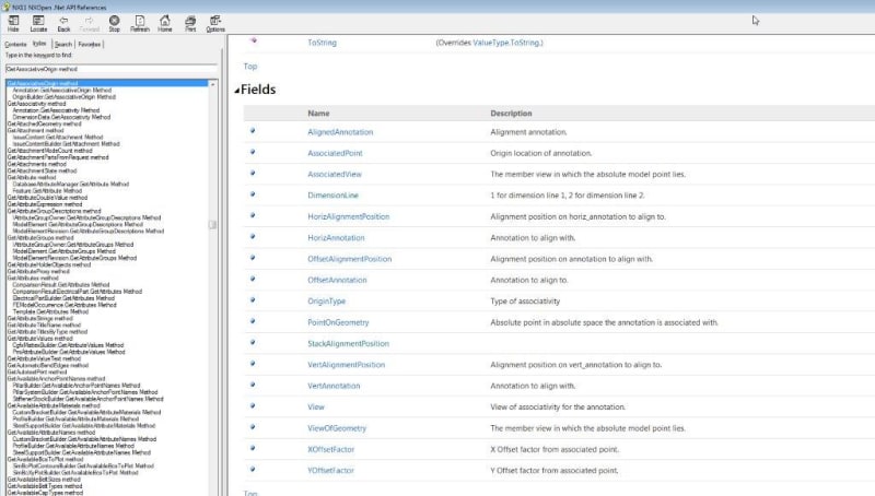

Hi -
In NXOpen - VB.Net I will kindly ask one of you guy's:
I'm trying to get the Tag from the associated Drafting Entity, when a selected Drafting entity is picked on the active NX drawingsheet....
1.Say I have "Dimension 1" which is associated to antoher dimension (Dimension 2).... ( Horizontal alligned, Vertical alligned, Stacked etc. )
I would like to get the Tag of Dimension 2 , when I pick Dimension 1....
I am able to get the boolean Value - True or False, if I pick Dimension 1, by using "myDimension.HasAssociativeOrigin"...
But I am strugling a bit, to figure out, on also to get the Tag of the Dimension 2
If any of you have a direction, I can follow, please comment...
regards Lklo
The .GetAssociativeOrigin method will return information about the type of association and the annotation that it is associated to.
www.nxjournaling.com
Hi Cowski -
As always - thanks a lot for your reply , when I ask here at EngTips....
I have already tried the method: GetAssociativeOrigin , but I will give it yet another try tommorrow...
I can get a lot of information out of this method - but not the Tag itself from the Annotation that my dimension is associated to....
regards Lklo

Below is some code that I wrote a while back that may help. It runs through all the dimensions in the part and reports the associativity.
Code:
Option Strict Off

        For Each tempDim As Annotations.Dimension In theSession.Parts.Work.Dimensions
            lw.WriteLine("dim tag: " & tempDim.Tag.ToString)
            lw.WriteLine("has associative origin: " & tempDim.HasAssociativeOrigin.ToString)
            If tempDim.HasAssociativeOrigin Then
                Dim tempOrigin As Point3d
                Dim tempAssOriginData As Annotations.Annotation.AssociativeOriginData
                tempAssOriginData = tempDim.GetAssociativeOrigin(tempOrigin)
                lw.WriteLine("associative origin type: " & tempAssOriginData.OriginType.ToString)
                Select Case tempAssOriginData.OriginType
                    Case Is = Annotations.AssociativeOriginType.Drag
                    Case Is = Annotations.AssociativeOriginType.RelativeToView
                    Case Is = Annotations.AssociativeOriginType.RelativeToGeometry
                    Case Is = Annotations.AssociativeOriginType.VerticallyAligned
                        Dim alignedAnnotation As Annotations.Annotation = Nothing
                        alignedAnnotation = tempAssOriginData.VertAnnotation
                        lw.WriteLine("aligned to annotation: " & alignedAnnotation.Tag.ToString)
                    Case Is = Annotations.AssociativeOriginType.HorizontallyAligned
                        alignedAnnotation = tempAssOriginData.HorizAnnotation
                    Case Is = Annotations.AssociativeOriginType.AlignedWithArrows
                        alignedAnnotation = tempAssOriginData.AlignedAnnotation
                    Case Is = Annotations.AssociativeOriginType.AtAPoint
                        Dim associatedPoint As Point = Nothing
                        associatedPoint = tempAssOriginData.AssociatedPoint
                        lw.WriteLine("aligned to point: " & associatedPoint.Tag.ToString)
                        lw.WriteLine("  " & associatedPoint.Coordinates.ToString)
                    Case Is = Annotations.AssociativeOriginType.OffsetFromText
                    Case Is = Annotations.AssociativeOriginType.AttachedToStack
                End Select
            End If

hi Cowski -
Thank you so much....Your code snippet is Exactly what I need...
I did try play with "GetAssociativeOrigin" before my initial post here - But I totally missed, that the Tag's of the different allignMethods,
would point directly to the Annotation, that is Associated To....
Thanks again..
best regards...Lars
