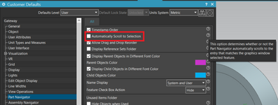

The part navigator has an option to scroll to the feature that has been selected in the graphics window. I'm not sure if this option will automatically expand feature groups or not.

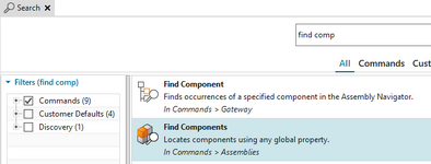

@CAD2015 Couple of commands specific to find component(s) are 'Find Component' and 'Find Components' (Use the command finder).
Later one provide multiple search criteria's to find any component but it depends on how you want to find or locate it.
