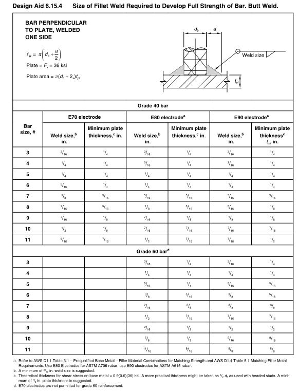

Jul 12, 2019 #1 Veer007 Civil/Environmental Joined Sep 7, 2016 Messages 379 Location IN Hey guys, i have to weld a 25mmØ rebar with 19mm thick bearing pate, is there any details for weld standard to develop its full shear and tensile capacity of rod? Also 19mmØ rebar. (FILLET WELD , ROD PERPENDICULAR TO PLATE) Thanks in advance!!

Jul 12, 2019 #2 KootK Structural Joined Oct 16, 2001 Messages 18,690 Location CA The PCI manual has convenient design tables for this Upvote 0 Downvote
Jul 12, 2019 #3 Ingenuity Structural Joined May 17, 2001 Messages 2,374 Location US You did not state the orientation of the rebar-to-plate. Here is PCI's info from their Handbook (7th Edition): Upvote 0 Downvote

Jul 12, 2019 Thread starter #4 Veer007 Civil/Environmental Joined Sep 7, 2016 Messages 379 Location IN The rod perpendicular to plate, i need fillet weld size Thanks in advance!! Upvote 0 Downvote

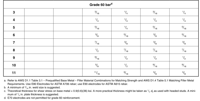

Jul 12, 2019 #5 Ingenuity Structural Joined May 17, 2001 Messages 2,374 Location US PCI Handbook chapter 6 has these design aids: A more legible part-image of above, for Grade 60: Upvote 0 Downvote
