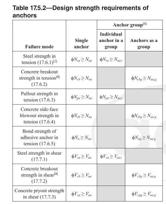

Further to bones' point, 318 indicates not pryout check for individual anchors within a group of anchors. The intent there seems pretty clear.
I guess what I'm saying is that pryout capacity near an edge will calc out to be less than pryout capacity in the middle of a slab. Just because the tension breakout area is reduced. I don't know how closely that reduction estimates the true pryout-near-an-edge effect, but at least there is some reduction in capacity. If the "breakout area method" is an acceptable estimate for tension breakout near an edge, I don't see why it wouldn't also be a good estimate of pryout near an edge.
