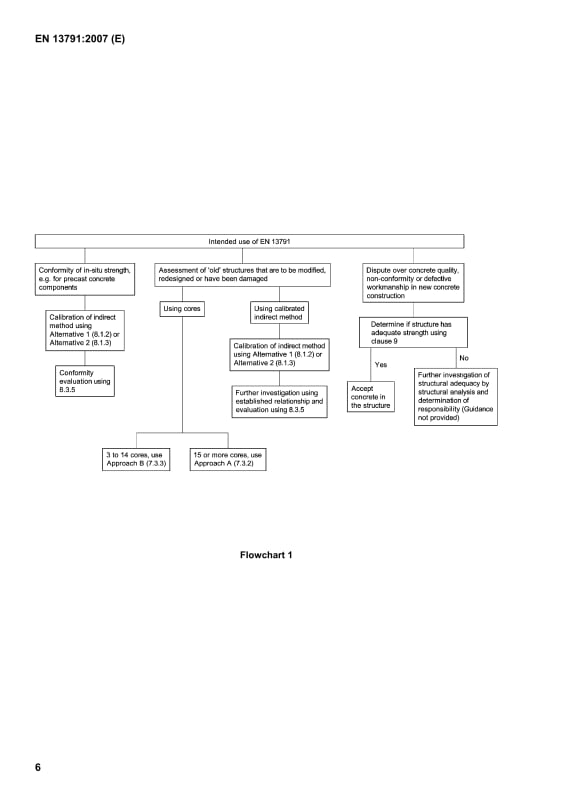

further to what said, in case you need to check the concrete after building (assessment in situ), then you can't use EN 206 (you don't have any more the fresh concrete) but you can follow the procedure as per EN 13791
