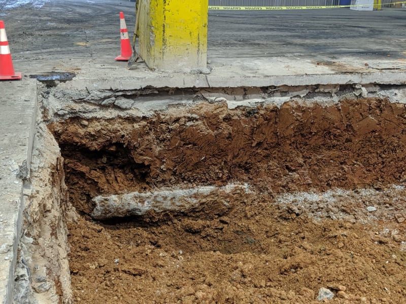

Not sure if I should post this in geotech or structural so I’m going to post in both. I’m one of those geotechnical structural engineers...
I got a call from a construction company that we work with...this one stumped me.

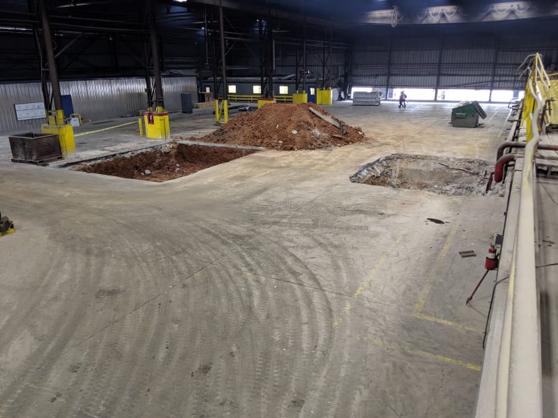

They’re installing a new equipment pit that’s about 20’ deep. Immediately next to said pit, are a line of columns that look to be spaced about 20’ apart (I don’t have measurements, just guessing from pics). The site is a state over or I would look at it myself.
They initially wanted to install strip plates along the slab to tie some of the columns together at the bases and wrap around to help distribute some of the load. I don’t see this working since now I don’t have any columns I can tie back to. I have no clearance whatsoever between the soon to be pit wall and the footing under the column. They are just now starting to do exploratory excavation.
I’m trying to brainstorm ideas on how to reduce the ZOI pushing on the soil nailed walls that they’re going to be putting in. They need something that is going to keep the walls stable. I know they want to avoid putting in piles because my first thought was tie backs. They want to know if there is another solution that’s easier to install.
Of course today is the day EVERYONE is out of the office too. Any ideas are welcome! I attached a picture of the column in question and this is just the first layer of excavation.

That was my first suggestion and they are wanting other options... they’re already installing other micro piles at other locations. I am almost to the point where I want to say I think they excavated to close to the footings and now it’s time to underpin them and add tie backs for additional support since they took the ZOI away when they removed ALL of the soil around the footing.

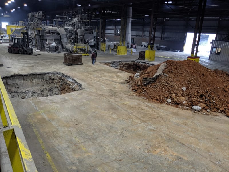

They are supporting the all of pit walls with soil nails as they construct. As for the pit, it's going to be at least 30' wide and 50' long. Keep in mind, it's not a rectangular pit, more of a tetris shape I'll call it...
