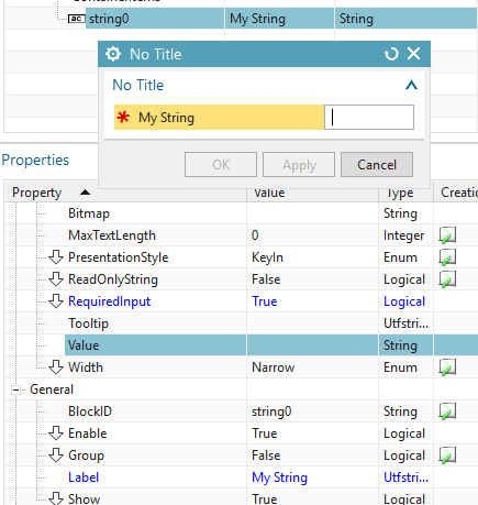

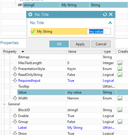

The 'Required *' is something that needs user input and reserved for selection blocks.
You can add it to the dialog though using labels:
- Create a label block and add text 'required'
- Create a label block and enter 'asterisk' as the Bitmap Value
- Use Other, Attachments to position appropriately
I still have problems.
Because my dialog is with some options
and in each option some blocks are hidden
and some shown and if one with the
Required option is hidden I need to check
If its required still active and so on.
