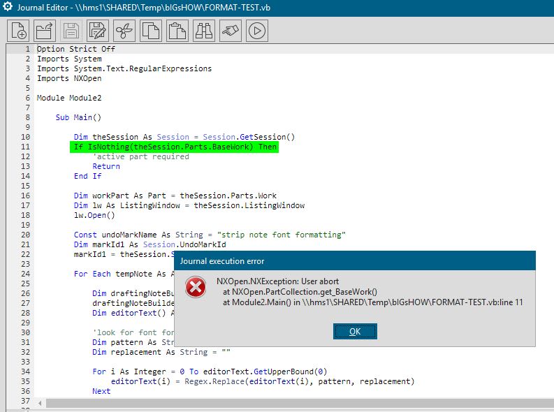

Sorry cowski
Ive been pretty busy today and just had a chance to see this.
When I ran it, it just gives me a spinning wheel. When I hit stop, it gave me this error....
I noticed that line has "Basework" used but I dont see any other reference to that anywhere else in the code. Would that be the reason?
Outside of code, the only notes left that have formatting are already transferred inside the views. Perhaps it is only looking outside the views and just doesnt find anything?
I truly have no idea. Just taking shots in the dark here. lol

The error message is "user abort" which is just telling us that you stopped the process. It is strange that it highlighted line 11; that line is just checking to see if you have a part file open. The journal won't run the rest of the code if there is no active part file. Maybe they changed something in the API and Parts.BaseWork isn't the preferred option any more; I'll look into the NX 2312 help files. As long as you have a file open, you can comment out lines 11-14 and try it without the "active part" check.
I tested the code on NX 2206 with a drawing that had a handful of notes, only 2 of which had text formatting. It worked whether the notes were created in an expanded view or on the drawing sheet itself.
How many notes are in your file? Perhaps it is just running slowly because of a large number of note objects?

Your are correct cowski
It was just running slow it seems. I ran it and let it go and after a minute I caught a change in a note that lost its formatting. Another minute went by and it completed.
I think what fooled me is that there is no window that pops up or anything. So it looked as if it was stuck with the spinning blue wheel and it didnt do anything right away.
Overall it seems to work perfect.
