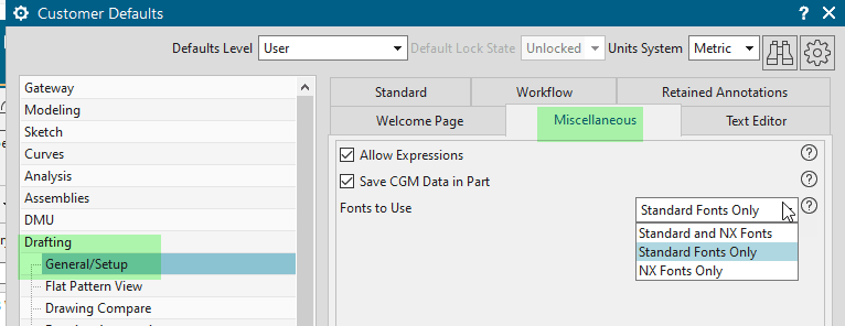

Have you looked at the old "Unigraphics fonts" ?
True type was implemented in, i think, NX8.5, before that all fonts was single line.
These fonts still are included in the install but in later versions of NX you must enable these to appear in the session. Else you only see True type fonts in the dialogs.
Customer defaults- something ... ( im not on a computer where NX is installed at the moment.)
NX also has e very straightforward engraving option which uses these fonts.

Here's the option :
( NX1980/2000)
Select the Standard and NX fonts, save the customer defaults , restart NX and you should see the old style fonts.

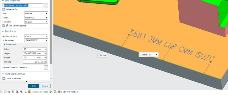

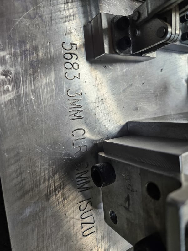

I use the "modern" font for text that's going to be engraved
Rob N, that's the font we user for "on curve" engraving even on doubly curved surfaces, but because it's a series of straight lines it's difficult to use if you want to simulate a ball cutter in 3d. I feel the pain of the process but there it is, and it's still better than other cad systems.
