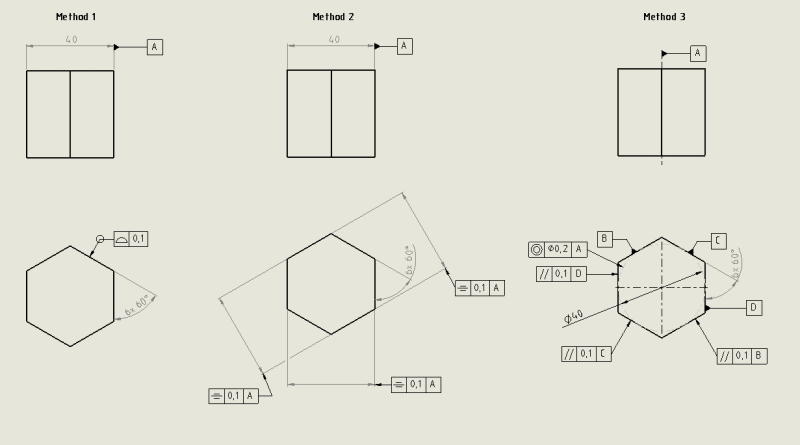

What's your approach for tolerancing concentricity of a polygon, see attached image
I'm new to GD&T. What's your approach of tolerancing a polygon shape.
'Profile of a surface' as in option 1 locks down a lot.
At first I thought it looked down too much so I tried Method 2 using symmetry, which in the end pretty much did the same as profile of a surface.
Then I thought of some dotted inscribed reference circle with concentricity tolerance, along with parallellism tolerance.
Brain is confused to say the least. Suggestions?

I would have to state the ubiquitous "Depends on the function of the part" first... Secondly, I would tell you that symmetry is rarely used in my experience, and Profile is much easier to understand, measure, and more easily captures design intent in most cases. Concentricity is interesting... Each of those methods looks theoretically sound, but would depend on function and/or the condition of the mating part. In the industries where I've practiced GD&T (firearms, Power, communications, defense, aerospace), profile of a surface would most likely be the default tolerance to use there.
EDIT: Also! Concentricity and symmetry have been removed from the 2018 standard, so there ya go... Was this a test?

As Hallec mentioned, profile would definitely be the first choice. I would avoid symmetry/concentricity at all costs for the same reasons that were mentioned - they are very rare except in very specific circumstances and are being phased out in the new release of the Y14.5 standard as a result. If profile results in a tolerance zone which is too tight - I am not 100% acquainted with the specifics yet as it just came out but the 2018* version has a new "dynamic profile" modifier that could be useful, which I believe works like a runout control for shapes other than those of revolution (ie: allows the tolerance zone to uniformly expand and contract). If the actual form tolerance of the profile can be tight, but location of the feature to the DRF can be loosened then multiple single segment profile or composite profile tolerance may be an option - keep in mind though that depending on the DOF constrained by your DRF some unintended consequences may arise (ie: if rotation is unconstrained - polygons with an increasing number of sides nears approximation of a circle and depending on the size of the tolerance zone/exact shape of the polygon the feature could rotate further than you might expect within its tolerance zone).
The shape could also be specified with directly toleranced (+/-) sides and angularity controls to a common DRF, or you could even do something like a wide profile tolerance and tighter angularity controls on each surface, however you have to keep in mind the variation allowed by these methods - the tolerance zone will not expand/contract uniformly.

Method 1 looks like the best choice if you intend to control the form only. Since the all-around profile doesn't reference any datums, it will not control the size of the feature. If that is the intention, remove datum feature symbol A from the side view. Also, the angle should be basic.
Method 2 won't be well received from the reasons already mentioned in previous replies, but please note that it isn't applied correctly either: you need to derive datum A from some datum feature of width on the part, not from the 2 flats you control with reference to this same datum. Additionally, you need 3 datum center planes - one for each control.
Method 3 - as mentioned, just like symmetry, concentricity was removed from the latest ASME Y14.5 standard. If you follow the 2009 or previous revisions I think you can apply concentricity on a polygon (I've seen this shown in a book), but the control should be applied on the physical surfaces, not on the inscribed virtual cylinder. That is because the inspection involves deriving median points from physical surfaces. You will also need a datum axis derived from an actual datum feature. Do not connect the datum feature symbol to any center lines. The downsides of this method were also mentioned in previous replies.

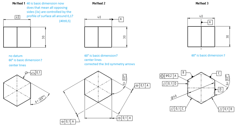

I have a new image with some corrections on the 3 methods. I will have a closer look at this when I get home.
I followed some advice here and put some basic dimensions and center lines in there.
Some questions in the image.
For example, center lines between opposing sides of polygon, good or bad practice?

"does that mean all opposing sides (3x) are controlled by the profile of a surface all around 0.1?"
Yes. Any form deviation mus fall within a 0.1 wide tolerance zone equally disposed about the true profile defined by the 3x 40 and 6x 60deg basic dimensions.

Regarding the corrected image:
Method 1 - 40 and 60° are now basic dimensions. If you add "3X" before the 40 the whole shape will be fully defined with the basic dimensions and a profile tolerance. The size and form will be controlled. I should correct my previous reply and say - the reason the size was not controlled previously by the profile is that 40 wasn't basic, not because of the lack of datum references.
Method 2, 3 won't become viable as long as there are no datum features for symmetry and concentricity. The datum features for symmetry can't be the controlled features themselves, and the datum feature symbol for concentricity can't be attached to a centerline. Attached is a fragment from Dimensioning and Tolerancing Handbook by Paul J. Drake, Jr. (McGraw-Hill) that might help you specify concentricity correctly for an irregular symmetric feature.
Also, I would remove all the center lines you showed on the drawing. I think that the only cases were center lines should be shown are axes of surfaces of revolution or when you dimension location of features from center planes.
RE: What's your approach for tolerancing concentricity of a polygon, see attached image
One more thing - there is no purpose for the basic 60° in methods 2, 3. Symmetry and concentricity don't control orientation (edit: between the controlled feature and anything but the datum), and thus the angle remains uncontrolled without a direct tolerance.

Reason I added center lines on Method 2 was due to symmetry, but then I thought center lines might make method 1 easier to read as well, and wanted to hear your comments on it.
Did not know that '...the datum feature symbol for concentricity can't be attached to a centerline' (SEM_D220), might have some GD&T documents on my desk I should throw away, cause I'm pretty sure that they used centerline for concentricity datum, along with another example where the datum pointed at the dimension arrows, and said it had the same meaning.
Method 2:
Thanks SEM_D220, I read up on how to measure symmetry and realize that (like you said) two opposing side, where left side look like this ) and right side like this ( They would result in a "vertical line/zero assymetry" if you took some symmetry measurements with the caliper (measuring at different heights along vertical axis with the caliper jaws opening/measuring horizontally.
As suggested, remove basic from 60° dimension
I'd also need to add parallelism to control the form. And from what I've read tonight I have to have the datum feature on a surface (instead of axis) if I want to control form with parallelism, in other words surface parallelism. On the image it was pointing at the 40 dimension arrow (axis in the center of polygon), which would not be correct in this case I believe (lots to learn). Need to figure out if I need surface parallelism or flatness on the faces... hmmm.

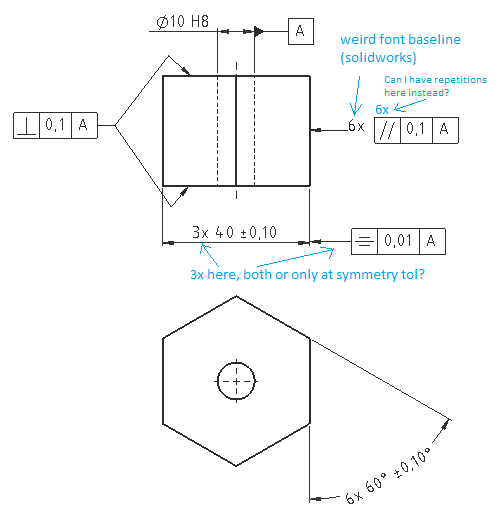

I need a center hole through the part and thought this might be a good way to control the geometry. The hole sets the datum A which is then referenced for symmetry, perpendicularity and parallelism in different view orientations (which may imply I need to have a new datum feature for each new view?)
If symmetry is allowed in the standard we work with, do you see anything being overdefined/conflicting/missing with this method?
I see a potential mistake, perpendicularity would only be needed in one view?
Perka, the datum derived from the hole is an axis, not a plane. All parallelism controls and the 2 perpendicularity controls can reference this datum. You can do that by simply adding "6X" before the parallelism control if the paralleliam control should be applied to each of the 6 flats. Make sure that the hole is a functional datum (what role does the hole play for this part?). By the way, I added a small correction to my reply above, make sure you noticed it and sorry if it was confusing.
The hole axis is the axis that the polygon need to be concentric about.
Thanks for clearing up the datum reference feature.
Flatness in combination with parallelism does not seem to be controlled on my drawing?
Parallelism is measured over the whole surface but the angle does not control the shape of a polygon face, right? Perhaps make 60° a basic dimension and add angularity tolerance(s).
^scratch that (if the angle at some point on the surface were to be much larger than 60°, the shape of the face wouldn't pass the parallelism tolerance)
Here is the progress so far

The parallelism tolerance does not control the 60 degrees angle. That angle is controlled by the direct +-0.1° in your drawing. Since you control each facet with reference to an axis, each facet can rotate about that axis to any orientation and still be parallel, hence no mutual orientation is controlled by parallelism. 6X can be above the feature control frame, not an issue. 3X should stay as it is and the feature control frame for symmetry should be placed under the dimension. Not sure about the two leaders that originate from a single perpendicularity control. All these are just technical tips, but you are strongly advised to consider the Profile scheme again. You could reference the datum axis at Profile and achieve the desired orientation of the external surfaces with reference to the datum axis. You are also advised to consider replacing symmetry with Position. Position is much easier control to inspect, and if the prime goal is centering of features, it is considered the preferred one.

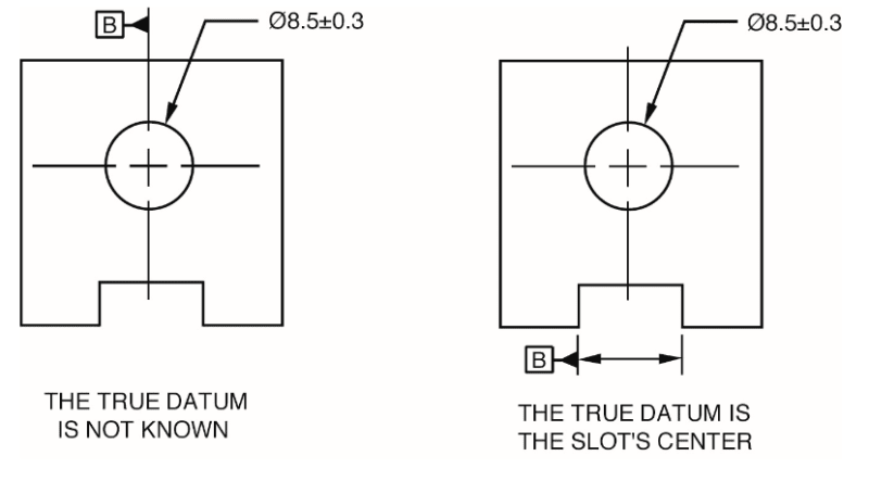

This was drawn from a comment by JP back in 2011 from this (https://www.eng-tips.com/viewthread.cfm?qid=292841) thread - all credit goes to him, I hope he doesn't mind my referencing it. Theres some good posts there about the ASME rules regarding datum definition/specification, however your best friend would be again to determine which standard applies in your workplace, and read through the applicable sections - theres no better reference than the primary source.
