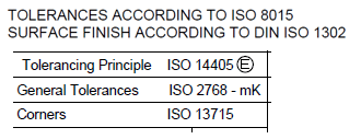

I have prints showing those ISO combinations. Now, knowing that ISO 2692 is invoked (as being an ISO drawing that is calling 8015) should I understand that:
- any linear sizes will have their envelope concept by default also invoked.
- there should be no coaxiality (concentricity, symmetry) callouts modified at MMR or LMR (at least per the theory specified in ISO2692).
Yes, that is true.
ISO 2692 says that: "Use of the envelope requirement (E) (previously also known as the Taylor Principle) [in conjuction with a geometric tolerance at MMR] usually leads to superfluous constraints regarding the function of the feature(s) (assembleability). Use of such constraints and size definitions reduces the technical and economic advantage of maximum material requirement, MMR."
This means that according to the standard, when applying a geometrical tolerance at MMR, (E) modifier should not rather be used, as it "reduces the technical and economic advantage of maximum material requirement".
May I force one more question: how ISO allows some linear sizes to take exception of the envelope requirement on prints shown with notes as such (previous posted picture) in order to use MMR/LMR?
Do we have to put E near other linear sizes? (And get rid of the general note E). Or there are other ways around it?
ISO 14405-1 defines LP modifier (two-point size) that, when applied to the size specification, basically cancels the default envelope requirement for particular size dimension in cases like yours, and makes the independency principle in charge again.
But I would like to repeat: ISO does not prohibit use of (E) modifier for features controlled at MMR. They just say that this combination isn't good idea from technical and economic perspective.
