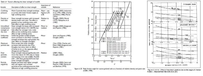

If your bridge lift is made up of crushed rock your loss in strength due to compaction is a lot less than that from increasing confining pressure as illustrated below. When you mention wet swampy land I envision thick organic deposits and normally consolidated or slightly over consolidated clays, you are going to be doing preloading which would fail due to excess pore pressures during construction in the low permeability clay before gaining strength.

to GEG: I'm referring to ordinary fill materials placed in a 3 to 4 ft initial lift. I'm not considering open-graded aggregate (i.e., drainage blanket). I'm also mindful of the native soil properties and understand the difference between compression and consolidation and effective ways to use ground improvement, surcharges and preloads (i.e., via Su/P'). My inquiry relates to a perception or reality of a low-strength zone within the actual newly-placed fill.

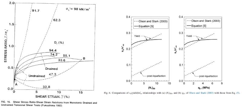

In my experience working with tailings dams which have a lot of loose saturated silty sand with non-plastic fines. The latest guidance I have seen is to determine if the loose sands will behave in a contractive or dilative manner, which is correlated to determining the relative density. If your bridging layer is so loose that it will behave in a contractive manner you would need to consider peak undrained strengths at the base of your model, for dams we consider the peak or yield strength proposed by Olsen and Stark 2003 which is back calculated from previous failures using the pore pressure conditions prior to failure.

To GEG, I understand critical state soil mechanics and went to graduate school with Tim Stark. I understand what you are talking about, recognize it as correct. I'm just talking about something else.
