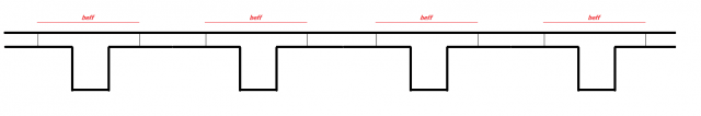

Hello,
I have something similar to the following structure:
In order to verify bending ULS, I calculated the effective width of the web, compounded with flange and took its Md and Nd.
My question is: When verifying Shear ULS, do I have to use the same section (flange + effective width) or can I take only the flange + web using only the width of the web?
Thank you!
Most codes state that you use the web width only, but you didn't say what country/code you are working with to be able to comment further.
Keep it simple and check it as a series of rectangular beams.
@Agent666: are they any Codes that state otherweise? I dont see how it could work?
1) I'd go with using only the thickness of the web. That, based on technical merit, precedent, and simplicity.
2) In a fundamental, mechanics of materials way, I'm not sure that it would even be correct to utilize the flange outside of the web for shear. Your vertical shear capability generally needs to be compatible with your horizontal shear capability which enforces strain compatibility between the parts of your beam in compression and the parts in tension. This is why we use the beam depth to the reinforcement rather than the overall height of the beam in our shear calculations.
3) I don't know that #2 is strictly true in a cracked, inelastic, non-linear, non-homogeneous material. There are precedents out there for somewhat separating vertical and horizontal shear capacity. One example is studs on composite steel beams. Another is using the average thickness of a tapered web concrete joist rather than the minimum thickness. These are, however fairly minor deviation from strict elastic theory which requires vertical an horizontal shear to be complementary at all locations.
For shear you would only use the webs, not the slab/flanges.

I believe he's asking about depth of section. You can use the total depth of concrete, i.e. slab plus rib depth. But as indicated many times already, only the rib width can be used.
You would use the width of the web plus the vertical distance, d, used in your flexural design as the shear "area". In other words, do not include the flanges outside the webs (between the webs) for use in shear capacity calculations.
