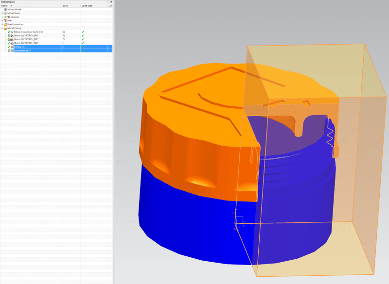

One workaround would be to use the "Assembly Cut" from the "combine" menu.
On your Assembly parent level you create a solid according the shape you want to cut.
With the Assembly Cut" feature you can then select that solid to cut out a section from the components you need to be sectioned.
