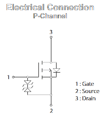

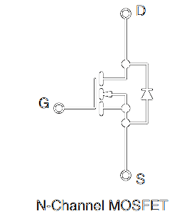

IR; I think those symbols are mis-marked! Notice the arrow directions compared to these two symbols I just cut out of data sheets.

As some articles point out, your original set of symbols are different than the ones that specify the body diodes, which are relative to the channel, hence, they point to the middle of the gate region. These, I think, are supposed to indicate the source terminal and direction of conventional current, hence ">" indicates a transistor where conventional current flows out of the source, making it n-channel, while the other device has conventional current flowing into the source, making p-channel. Moreover, the structure of the circuit suggests that the gate-source of Q10 is controlled by the common-source Q9, and the only way to shut off Q10 would be if Q10 is p-channel. Slight bias confirmation on my part, possibly.
{edit] I think this set of symbols is more consistent with BJT symbology. which likewise shows conventional current direction at the emitter. The body diode symbology was always an extra step for cognitive processing to say, "p-type" body, so "n-type" channel, so n-channel. BJT symbology, arrow points out --> NPN

Non-pointing-in doesn't work on the convention MOS symbol, because the arrow refers to the body diode. In your schematic, it should work, because the arrow is comparable to the emitter arrow on an NPN, and not referring to the body diode. The body diode is almost moot in most modern monolithic MOSFETs, because the body is often already shorted to the source. The body connection only made sense in multi-transistor ICs, because n-channel transistors running in a cascode or as a pullup would have their body junctions still at ground, resulting in a substantial increase in threshold voltage, compared to a ground source device. But, that sort of thing has mostly gone by the wayside since CMOS ICs became the norm.
Gunnar made reference to depletion-mode transistors, which were used in NMOS-only ICs as substitutes for high-value load resistors. They were the bulk of the devices affected by body effect threshold shifts.
