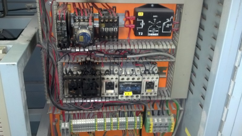

Our contactor supplies 380V off of two legs of three phase system to the primary of a
high voltage transformer. It is for Ultra violet light system on printing press. Previous
to me getting on seen this thing caught fire destroying several contactors and wiring in
cabinet with two other guys replacing components attempting to resurect it.
I put the unit in operation while monitoring current. Secondary output at moment of ocurance
was 10 amps, when contactor opens it starts welding melting contacts as seen in pictures.
Contactor in question is rated 400V @ 30A. I have posted schematic of circuit, contactor with
issue is K13 and capacitor bank is C2. The four capacitors are 30Uf and connected in Paralel with
accuall measurment of 117Uf.
What is funtion of capitors in this circuit and could they be causing the welding action of contacts?
If I were to connect them in Series for 7.5 Uf instead might that correct the problem?
Thank you, Chuck

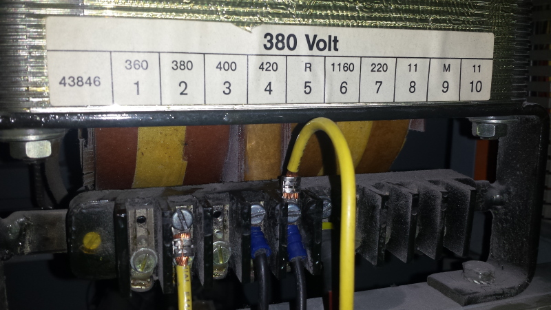

I don't quite understand your readings.
I'll give the sequence; Note: Let's round up the 219 Volts to 220 Volts for simplicity.
Apply 220 Volts across R and 220.
You should see the following readings with the capacitors disconnected:
Terminal R to terminal 360,- Should Read 360 Volts
Terminal R to terminal 380,- Should Read 380 Volts
Terminal R to terminal 400,- Should Read 400 Volts
Terminal R to terminal 420,- Should Read 420 Volts
Terminal R to terminal 1160,- Should Read 1160 Volts
No circulating current is a good sign. Many of the common faults would result in a circulating current.
You may want to do this test with the lamps disconnected.
I suggest energizing both ballasts and letting them sit, energized for long enough for the temperature to stabilize.
Then check that the voltages are what they should be and check for circulating current.
We want to rule out a ballast breaking down when hot.
Do this test with the capacitors disconnected. If the ballasts pass, do the test over with the capacitors
Bill

Yes Scotty I think your correct It's looking like the contactor is probably the cause because when I checked voltage ratios a while back with it connected 380, they seemed reasonable. I do want to make sure these things are balanced though and will perform the test as Bill suggested to remove all doubt I will try to get it right this time though. Thank you for pointing out the NEMA/IEC differences which could be substantial.

With 380 L1 connected across transformers 1&2 on the 380 terminals.
L2 connected across terminals "R" for a 380v supply to both transformers.
Transformer 1 Transformer 2
----voltage reading---
1. 199.6----199.3
2. 217.1----217.2
3. 233.3----234.4
4. 249.7----250.2
5. 216.1----216.2
6. 1097----1099
7. 112.4----112.5
8.201.9----204.1
9.212.7----214.5
10. 223.3----225.2
All readings are very close to same, I think variation showing might
be due to other loads in building and time taken to move probes causing voltage to deviate slightly.
I did repeate the current circulation test (correctly this time) and seen some current flow.
R to R lead was @ 410Ma
380 to 380 was @ 400Ma
1160 to 1160 was @ 30Ma
We received our quote for ballast $5,800 .00 Yeow! Hopefully you are going to say they are good Bill.

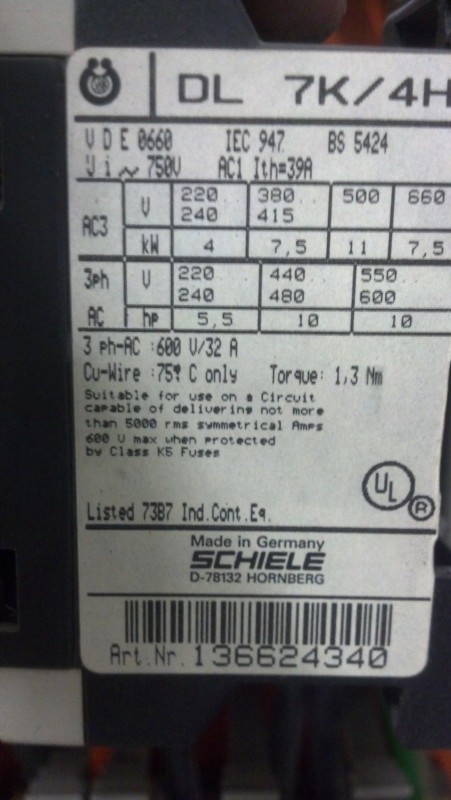

Was talking to my Manager about it and he remembered saving pictures of OEM contactor that burned up in fire.
It's only rated for 600V, I also included the first time it let the gremlin loose.
wowwee! That was a nasty gremlin..

Sorry Keith, I beg to differ.
Remember that when only one contactor opens There is over 1000 volts across that one pole. The current is limited to a low value by the impedance of the ballast, but it does not take much current to do a lot of damage if the arc is not interrupted.
The original contactor had a 660 Volt rating. The replacement may only be rated for 400 Volts.
With 1160 Volts across a 400 Volt rated contactor you don't need inductive kick to maintain an arc.
That last picture looks like sustained arc damage.
I support your first excellent suggestion to connect two p[oles in series.
