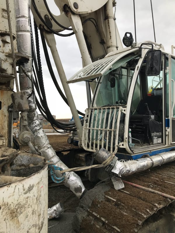

HELLO, WE have supplied a large amount of 5" concrete pumping hose (MWP 100 bar - TBP 200 bar.
It has been fitted to a stationary concrete pump that pumps concrete over varying distances to a Piling rig up the mast and down a flight Auger (CFA Auger.
This is a VERY HIGH SAFETY issue.

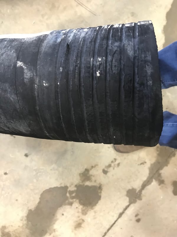

Within 6 months they have had two ends disconnect from the hose. Be it called 'blown off' or 'forced off'.
I can post the user report, but names are mentioned and first I would like to confirm my suspicion.
I have already advised to withdraw all hoses and place them on a pressure test.
The hydraulic power cylinder is 80mm bore with relief valve pressure set at 330 bar. they are directly pushing a 7" diameter concrete piston (steel rod connection)stroke 55". there is a short steel reducing pipe to 5" bore, this is then the start of the flexible hose line can be 20-30 mtr to the rig then vertical up the mast 15 / 20 mtr.
The set up worked for 4 - 6 months (289 piles bored and filled) this is not a lot of work.
The first failure was directly at the pump (1st hose-1st end) this was replaced with a new hose. the 2nd hose failed the day after at the base of the mast directly in front of the driver. These failures are 'explosive' as air in the concrete is compressed.
They have contacted the pump supplier (brand new pump) large international supplier and they have stated it is impossible for the pump to exceed 65 bar concrete pumping pressure. So the failure is due to bad hose and or bad fittings.
These failures can KILL.
When a blockage happens (I am told there have been lots of blockages) from a independent site visitor. I believe the hydraulic pressure / force is delivered direct to the point of the blockage in the 5" line. I calculate this is 131 bar.
Prior to the relief valve being activated.
I am working on a 'frictionless' calculation as I do not wish to complicate the issue with 'slump' 'friction' 'temperature' calculations.
I have sent an email with my 'worries' to the pump manufacturer as I say they are misleading 'users' about safety and pressure. this is promoting an "invunrability" feeling to users. So far they have not replied to my email.
We have done thousands of these hoses and not had reports of failures. I am very confident our product is good and calculations correct, but we are up against a very large multinational company. I have stated this is not to apportion blame but to work together to gain safety.
I have done pressure and tensile tests to confirm calculations on video, but having a problem with getting my point across.
I am hoping for someone with greater knowledge on hydraulics (a third party) to confirm if I am correct or not.

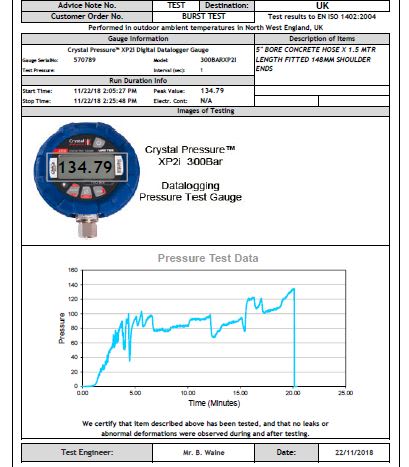

I have video of 10.2 ton on a dry end tensile, this was max length of stroke on the test rig 328mm.
I have also had a test piece under pressure of 100 bar for 7 days and nights, then increased to force the end off.
this a complicated test as the previous 7 days took all the 'stretch' out of the hose. this video is on Linkedin.

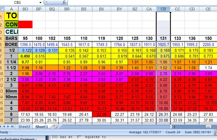

From your reply I take it you do not agree with my calcs that the blocked end on the 5" hose is 131 bar ?
The system becomes a totally hydraulic one when a blockage happens, Pascal says equal pressure in all parts of the system.
if you can reduce pressure going from 80mm to a bigger bore (177.8mm) you must increase it again if you reduce the bore to 5" is is on enclosed space.
330 bar at 80mm equates to 16.87 tons
330 bar at 7" equates to 66.8 bar (blank end area pressure)
330 bar at 5" equates to 131 bar

I have a large jetting pump and burst short lengths at over 200 bar (equivelent to 30 ton tensile). The test piece we put on for 7 days at 100 bar slowly stretched so we kept topping up to 100 bar. after 7 days+nights we decided to see what it would take, it pushed off slowly at 104 bar (I expected this) as we had used up all the elasticity.
So when I am told the pump 'cannot' pump at more than 66 bar It makes me explore all possibilities. My findings are that at the time of the blockage the pump runs up to relief valve pressure "330 bar" at this point in time it is an 'Hydraulic' system as per Pascal's Principle. When a force is applied to a contained, in-compressible fluid, the pressure increases equally in all directions throughout the fluid. ... Since the pressure is transmitted equally throughout the fluid in all directions according to Pascal's Principle, P1 must equal P2 (psi calc's to the area of the blank) 5" = 131 bar ... 31 bar over max working pressure.

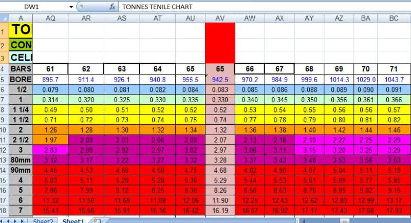

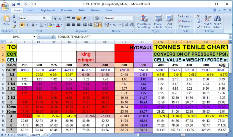

I am working on a gauge that will show both pressure and tonnage in a concrete line. In oil lines we set 'dry-breaks' this is not possible with concrete, but a 'wet-break' would be safer than a high pressure burst. Any one is welcome to visit to witness tests.

First off let's get the pressure thing sorted out.
You're halfway there already
"330 bar at 80mm equates to 16.87 tons
330 bar at 7" equates to 66.8 bar (blank end area pressure)"
The issue here is that pressure = Force/area.
For a piston, the only area that matters is the area of the face of the piston - in your case 7" diameter.
Once pressure is imparted to the fluid it can't magically increase.
If your PISTON AREA was a 5" piston then yes, you could get 131 bar, but it isn't, it's 7 inches. The force from the hydraulic piston is divided across those 38.5 square inches (7"), not 19.6 sq in (5").

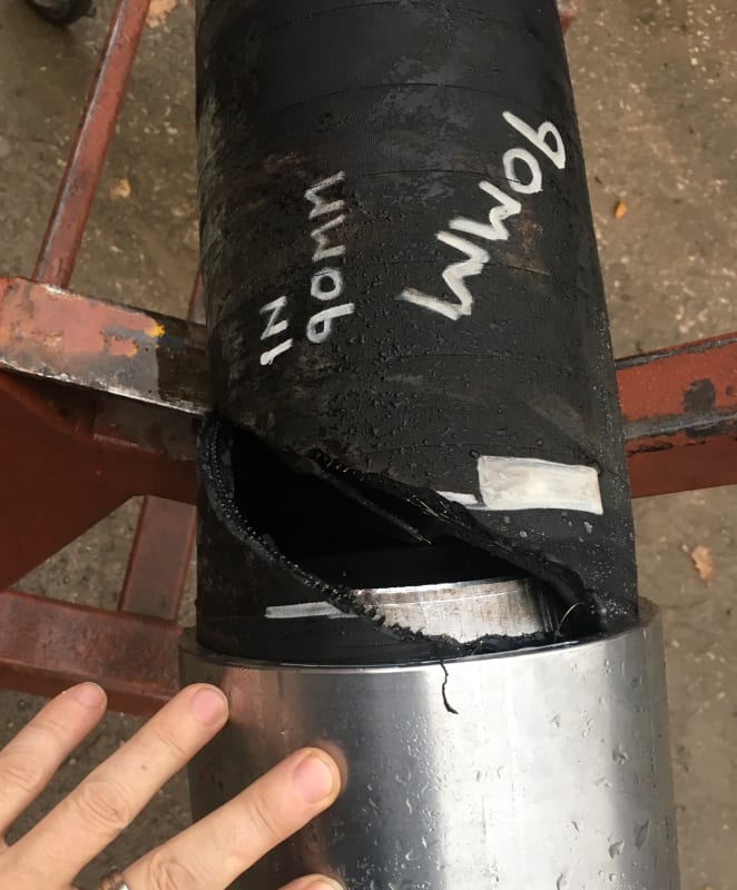

I have duplicated as near as possible the failure 'figures' with no movement at all. I have had to exceed maximum safe usage by a huge factor before I have had a failure.
Yes, the hoses are 'elastic' they are meant to be, so if you do over capacitate them, they will fail.
I feel as you say, the operator is evading some answers to actions, or covering up on miss-use.
W.E. can send you a cross-section of the crimp, I need to do from work next week, but here is a picture of a failed end.
I can put screws through the crimp that will either pass the failure to the next weak point (burst the hose) this is more dangerous, or it will find the next weak point in the system.

I also think it is operator error, but I still struggle to explain the ends failing with the tests I have done. There is only one source of power, and 65/68 bar is not a big pressure for these hoses or fittings.
When the fittings are crimped we take them to maximum displacement, we stop as the tail inside starts to reduce in size.

Ground Hose – November 13, 2018
• On Nov 13th one of the ground hose ends blew off. The end that failed was attached to the pump.
• Rig and pump set up on the day (starting at the pump) - ******** concrete pump - 40m long ground hose – 6.6m long steel catwalk piping - 4.6m long cab hose - 7m long steel mast pipe - 20m long hanging hose between the mast piping and swan neck. The drill rig was a SR65 with 19.5m of auger and a 6m extension.
• The outside temperature was ~ +6°C at the time of incident.
• This ground hose has been with this rig since it was purchased. So it would have been used to install 289 piles.
• We were just starting to concrete the second pile of the day. We were not aware of any blockages as the first pile poured fine, the move between the first and second pile was timely and there was no delay waiting for concrete. The crew said the hose blew immediately after kicking the pump on (2 pump stokes).
• The pump operator indicated the pump was reading a hydraulic pressure of 3,200 psi when the line failed, this would correspond with an approximate concrete pressure of 50 bar (725psi) based on the manufacturers documentation. The maximum concrete pressure is listed as 65 bar (942psi) for this pump.

Also when by the look of it when you say the hose end fell off, it doesn't look to me like the hose and the coupling came apart, but that it failed at the point where the hard fixed coupling suddenly changes to the hose. This is peak stress concentration territory and especially if there are no bend restrictors then it is not surprising this is the point of failure. I would recommend that the first 1m of hose is kept absolutely dead straight before any bending.
My suggestion for operating procedures is that on re-start with a full pipe of concrete, the pump is started as slowly as possible for ~ 30 seconds to close up any vacuum gaps and then slowly increased in pumping speed, if this is possible for the pump. If you ask about how they re-start might get you some interesting answers. I think miningman is having similar thoughts on the speed of start up.
WEBALL, I concur with Littleinch's comments regarding hose geometry at the base of the tower. I couldn't articulate why I don't like it, but Littleinch's suggestion, or at least a long sweep 90 degree elbow would eliminate my concerns. I have to admit that I have zero experience with piling but I do know that pumping downhill is a lot more problematic than pumping against gravity. And there was something about having a long vertical hose on the hose discharge that concerned me , but again I couldn't articulate why. So yeah , Littleinch's suggestion regarding vacuum makes sense, and yes, slow, low pressure at restart up is just good practice at all times. Of course all of this is leading towards poor operating practice as the root cause. As a lowly equipment supplier, trying to defend the integrity of your product, you and the end user may want to engage the services of an experienced independent pumping specialist to provide review and recommendations on the existing operating techniques.
Having said that , perhaps it would make sense to inquire as to any possible changes in the chain, since almost 300 piles appear to have been sucessfully completed. Any personnel changes at the batch plant or pump?? Any reason to think the mix design has changed, either deliberately or inadvertently?? Is air entrainment or Super P being used in ideal quantities. Has the overall length of pump hose increased??

I have had to put more than twice the 'energy' into the 5" line to get the hose to fail, even on a part crimped end. there is something happening that I am not aware of.

I can keep fitting hoses and testing all day, but my results are similar each time. We have supplied thousands of hoses and pipes, normally they get changed when they show external wires from pulsating along the floor or burst from external damage, sharp edges, around corners, it is about the most aggressive use a hose can get on rough stone sites.
What I am striving to find is how this much energy is getting in the line. The man I had visit the site has 30 years experience and was a Rig driver. They have now started a new rule in the UK where there has to be 2ndary containment, but this is last resort, and still dangerous. putting lower pressure flex's for land lines is a good thing as these go first, but if you have a well trained crew they can get a set of 100 mtr hoses lasting over a year. There is a good amount of skill in a good team.
i am doing a set of drawings to post as I think something is happening that we are not aware of. Occam's Razor is a good place to start.
