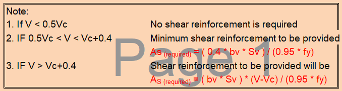

Would you guys mind telling me how you undertake the structural design of embedded walls. I am newish to all this and still trying to learn.
One method i have seen, which is based on the British Standard, is to use the concrete column charts,which determines the % of longitudinal steel required based on your shear and bending moment? See below.
Shear reinforcement is calculated based on the As required formula below. with V being the Ultimate shear force divided by the area of concrete. and Vc based on (BS8110: PART1, TABLE 3.8)
