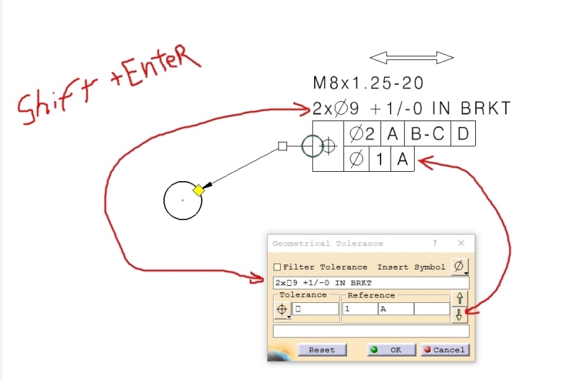

Is it possible to create the feature (Geometrical Tolerance) shown in the picture below of one (without adding another Geometrical Tolerance)?
I have created it using 4 different elements:
1) - Text
2) - Text
3) - Geometrical Tolerance
4) - Geometrical Tolerance
CAD 2015

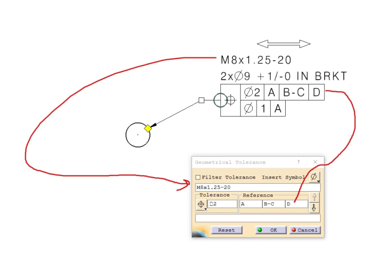

For Top Line of text and GDT:
For Bottom Lines down arrow for GDT and shift + enter for 2nd line of text:

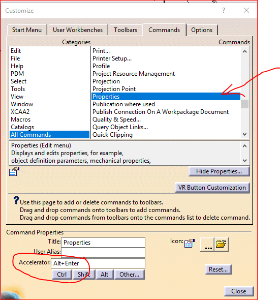

I am not sure how to follow your directions, Alt+Enter open the Properties tab............[mad]
CAD 2015

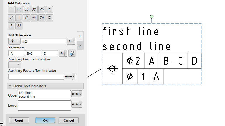

SHIFT+ENTER when in text box create an hidden /n character to go to next line

I went back and corrected my post.
Shift+Enter will bring you to the next line the text editor as well.
I had Alt+enter on my mind for some reason!

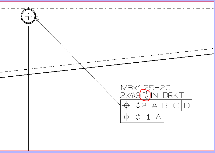

There is another question related to this thread.
Please, have a look at the picture below:

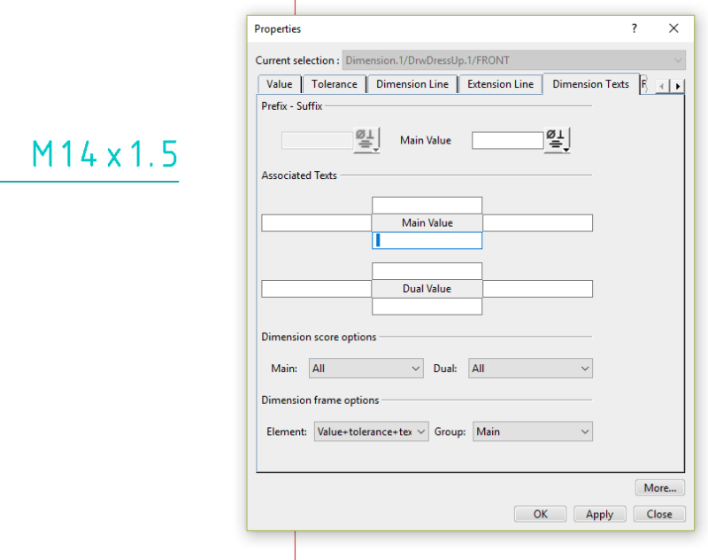

How should we add the +1/-0 value(red circled) in the same way that is shown in the picture (overlaid)? We know that this value should have smaller size.
Thanks!
CAD 2015
ok I am not sure going with Annotation texts is the best solution as the definition of sub text properties in annotation text is hard to get.
if you want associative dimensions I would suggest you create:
the M8 dimension
edit the dimension and add a <space> to the lower text:
then the 2xø9 text
locate the text over the <space> created in step 1
link position of text to dim1
edit text and select "ø9" in the drawing not the GUI, go RightClick : insert attribut link, select the 3D feature to get the real "ø9" so text value is linked with 3D feature.

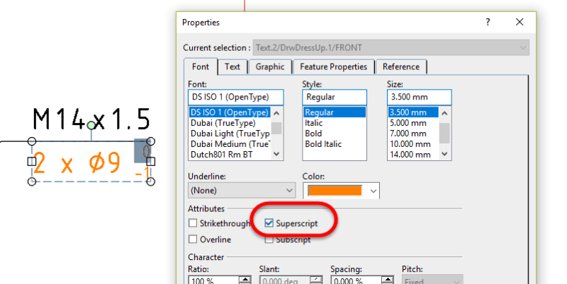

Then add tolerance as text <space>0-1
select <space>0 , in text property select Superscript
select -1 , in text property select Subscript
you need to have <space> and "0" as superscript if you want the digits (0 and 1) to align
Finally double Annotation to dim 1
it will be place automatically below the text as catia knows there is a sub text (the <space> added in step 1)
Hope this help

CAD 2015
I would keep them separate. Dimension the hole first so that it updates to the 3D model of the hole and then add the GD&T box onto that dimension. This provides the most update-ability of the drawing to the 3D CAD.
