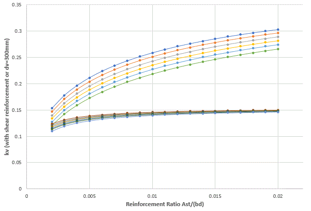

I've done some algebraic manipulation of the General Method equations to get a feel for what they mean in practice. I've done two cases:
A) Minimum M* as given in 8.2.4.2.2(a)
B) M* = phi.Mu (approx.), called M*max below.
The assumptions include:
[ul]
[li]No prestressing or axial force[/li]
[li]phi(bending) = 0.85; phi(shear) = 0.70[/li]
[li]dv = 0.9*d[/li]
[li]Fy = 500 MPa; Es = 200 000 MPa[/li]
[li]M*max/dv = 0.85*Fy*Ast (ie lever arm of tension-compression couple = dv = 0.9*d; tension force = phi(bending)*Fy*Ast)[/li]
[/ul]
Setting V*=phi.Vuc then means that kv can be found by solving a quadratic equation:
0 = a*kv^2 + b*kv + c
For Case A (minimum bending moment): a = sqrt(f'c)/(84.6*p); b = 2.5; c = -1 (where >Asv,min provided) or -1*1300/(1000+kdg*dv) (<Asv,min; see equation 8.2.4.2(1)).
For case B (~maximum bending moment): a = sqrt(f'c)/(169.3*p); b = 6.485; c = same as Case A.
Where p = reinforcement ratio = Ast/(b*d).
In the graph below; the upper rainbow is for Case A (f'c=20 to 65 MPa from top to bottom); while the lower rainbow is Case B (20 to 65 top to bottom again). This graph is for sections with >Asv,min; otherwise for dv=300mm only. For other depths of sections with <Asv,min (in the range 200<dv<1500mm), this graph is a reasonable approximation to:
Case A: kv/(DF^0.7)
Case B: kv/(DF^0.9)
Where DF = depth factor = 1300/(1000+kdg*dv).
So the Simplified Method factors pretty much assume the section is ~fully utilised in bending. For <Asv,min, a lower bound is used; >Asv,min uses close to (but not quite) the lower bound.
Next task is to plot AS3600-2009 to see how it compares given it had no dependence on bending moment.
