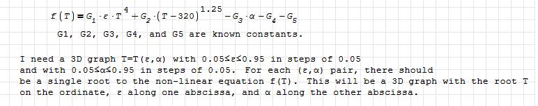

Guys I installed SMath and couldn't figure out how to do what I want to do:
Some guidance is appreciated. I'm publishing a journal article and a 3D graph would be a really good, eye-catching way to bring home an important point to the readers. Does SMath do multi-variable graphs?

If you already have the roots (based on previous replies you have been given a few options to find them for all the combinations of alpha and epsilon), then whats wrong with simply using a 3D surface chart from excel?
Arrange the data in a table with alpha horizontally, epsilon vertically, select all the data range for the roots without the labels. Then select insert recommended chart, find the 3D surface chart under all charts tab and add this. Right click on the chart and select 'select data', under Horizontal (category) axis label, select edit and set it to one of the the 0.05 through to 0.95 alpha range labels at the top of your table for the labels.
You will see a group of series, these are each of the rows in your table of roots of T, edit each series and for the series title make it equal to the cell which contains the row title for epsilon.
You should now have a 3D plot of your roots vertically with respect to alpha and epsilon on each of the horizontal axes. Play around with the colours/fonts/axes as required.
I'm very rusty on Smath as I'm not allowed to install it on my work PC and Andrey hasn't released an OSX version.
To the best of my recollection you can do 3d mesh like plots, but not contour plots.

That's a fairly unpleasant function to find the root of. Assuming Smath agrees, I think you are back to Newton Raphson. Have you got typical values G1...G5, and T such that f(T)=0? Probably the quickest for you is Doug's suggestion and VBA, but I'll have a noodle around in Octave to see if it is fun.

Thanks guys. I don't think Smath is a good candidate to do this because, for one thing, I don't think it can do 3D graphs. Probably the best solution in the long run is to use MS Excel with VBA and Goal Seeker since Excel has good 3D graphing capability.
Agent666 no I don't have the solution data for the equation so it's not just a graphing exercise.

I had a look at the ugly equation. Assuming G1..G5 are Real, for a given alpha and epsilon, all terms bar the second are Real, so for a real root the second term must be real. If T<=320 it is complex. None of the others are ever complex, if T is real.
The last 3 terms are just a constant. The first term looks like a parabola, the second is similar to a straight line. In other words on a graph it all just looks like a quadratic.
So ignoring petty details, you either have 2 repeated roots, no root, or 2 different roots.
How do you select which root you want to plot?

Why not post the constants, then people can have a real crack at it if it indeed requires a numerical approach.
You ought not constrain yourself to one tool or another. There's no reason you can't use SMath to do the math and something else to graph it, which is pretty typical in academic papers.
