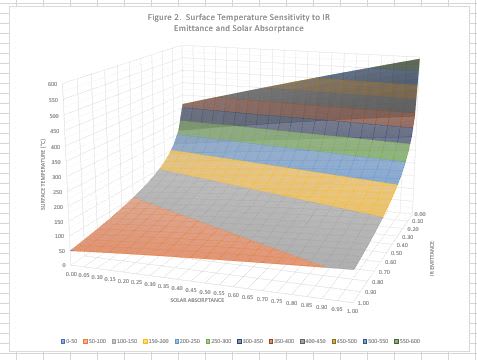

Thanks for all the productive ideas! For lack of time and money, I ended up using MS Excel with its GoalSeeker solver. It took about four hours because it tool solving (using GoalSeeker) 212= 441 times. I changed the domains to go from 0 to 1 rather than 0.05 to 0.95. There was one real root for each pair. Then I did a surface plot and here it is:
I think it looks pretty cool and adds a good visual to the paper.
The constants are:
G1=9.4083X10-8
G2=0.767
G3=1005.6
G4=1129.5
G5=53.0
Thanks again!

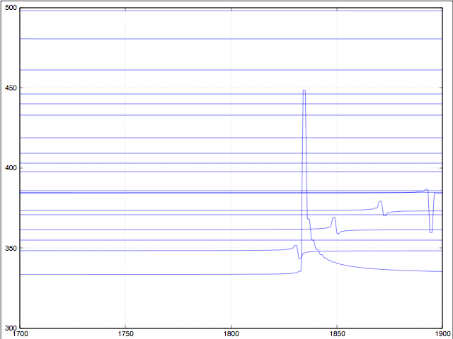

Well that's annoying, the previous answers were wrong because the initial guess was wrong. I should always plot the function out.
In this case it would be a good idea to plot the first one and use the root of that as the guess for the next run.

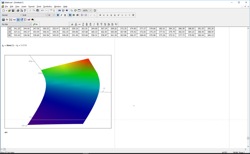

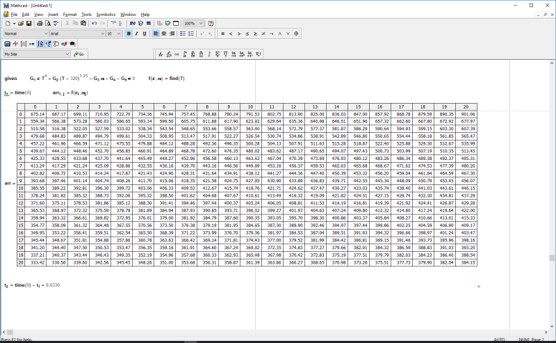

just for giggles, the problem is set up in Mathcad, and the answers are identical to IDS'.
Mathcad took 33 milliseconds to solve the 441 iterations, and it took about 10 minutes to set up the problem

Here's a plot of the progress, x axis is iteration number, y axis the current estimate of the root
So, something very nasty in the woodshed for a few of the values, although it recovers neatly enough
