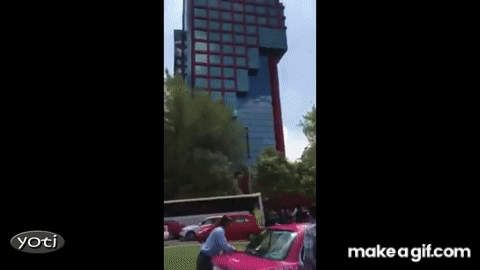

Watching this building in Mexico City whip & twist during the Sept 20, 2017 Puebla Earthquake, it struck me that the acceleration of any large pieces of furniture that were not nailed down could be extremely dangerous to anyone in the building on the higher floors. It might even be difficult to stand while in a doorway. Maybe it is a life safety issue even before it is a structural issue? You could have lots of occupants unable to walk & no elevators.
