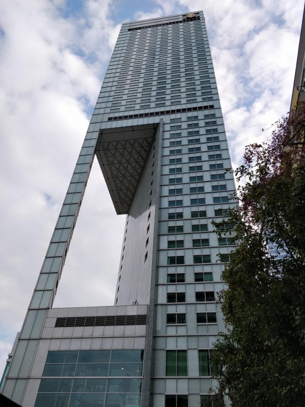

I stumbled across this little gem in Warsaw, Poland on the weekend. Wonder what K Factor they adopted...
I cant imagine thats taking all the axial load of 20 floors, perhaps theyre relying on transferring loads back to the main part of the structure.
Must have used an HP calculator for that one.
Keeps things nice and simple for the terrorists.
Tommy's paper looks informative. Anybody know enough German to help us parse out any interesting bits? I'd be curious to know if the building has been designed with specific robustness in mind. The top floor and mid-height transfer level both look as though they could harbor pretty substantial structure. And the core is not interrupted by the building cut. Perhaps the thing could survive the loss of the mega-column.
Written by designer:
....This 5-star hotels distinct architectural style with its outstanding open space on the lower levels is based on building constraints that stipulated that the residential units located behind the hotel had to receive a certain minimum of sunlight!!!. This task’s solution turned out one highly specific challenge for our engineers and, at the same time, contributed to the structure’s appeal....[surprise]
