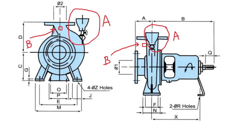

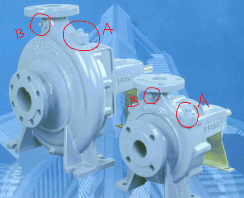

Hello friends, I was wondering, what is this connection on the case of a centrifugal pump intended for? Pressure sensor? Overheating probe?
Air bleed / priming.
Ah, thank you! How do you go about using it? Run the pump and unscrew slightly until water comes out?

Here is a pump with a connection somewhat like the one you are showing.
Sometimes its possible to do all the right things and still get bad results
Pennpiper, indeed it is an Ebara pump :) I have not seen that second brochure before - good find. From the diagram within, the "A" does appear to be for priming seeing how it has a funnel drawn on it... Do you interpret it the same way?
But wait, there's more! There is also port "B". (I did not bring this up previously to avoid confusion). Any ideas for that one?
Well if A is fill, then the higher B is the vent.
I've never seen anything like this funnel thing before though.
Given that one use is for "swimming pool" may be its a way of adding chemicals? That one's a bit off the wall....
B is only a vent if there is a NRV or similar on the discharge, being top centre discharge, the pump is self venting.
The accessory sheet lists the location "A" for a "priming funnel".
See page 1
The priming funnel would be handy for an pumping operation like a swimming pool pump where the system is used only seasonally and must be drained. Filling and draining pumping systems may take some time if the pumping system designer does not anticipate what is required to accomplish the fill/drain tasks.
Note the drain plugs in the photos.
Ah, yes, very good observation! Surprisingly few pump makers (Ebara notwithstanding) include those by default.
usually not included in heavy duty process pumps as it / they are a point for erosion.
