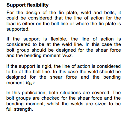

I am designing the fin plate connection manually,
1) How do you calculate the eccentricity "z" of connection, when the fin plate is welded to web as well as to flanges of the supporting beam.
SCI P358 dont have guidance for this case.
As per the AISC design manual, this welds dont provide enough torsional restraint so it is better to consider z as dist from web of supporting beam to 1st bolt line (for single bolt line).
Does anyone know the rigorous method which gives exact z for this case.

4/ See below:

I really appreciate your explanation for point no. 4, which has cleared my doubt.
Now for point no 1:
SCI P358 has the guideline to calculate the eccentricity z, for fin welded only to web of supporting beam,
But in case fin plate is welded to web as well as both the flanges of the supporting beam (please refer attachment posted on 6th july), can i take the advantage of the stiffening provided by the weld connecting the fin to flange, and reduce the eccentricity z?

Point 1 extent: In this case, it depends on (i) the thickness of the fin-plate to beam web, (ii) thickness of welding to supporting beam => so you may assume it is a rigid support and bolts are to be checked for shear only.

Istructeuk, regarding the response to Point 1, not sure I would agree with the fact that you can design it as rigid and only design the bolts for shear. The load is still ultimately being carried through to the supporting beam web so there is a bending moment on the bolts/welds. With welding to the flanges there is no argument that the connection is more rigid, however you cannot avoid the eccentricity in applying the shear.

Unless the supporting beam is braced against torsional rotation, the bolted connection has to carry the moment due to the eccentricity (centerline of the supporting beam to the bolt line) as well as the shear. Since the fin plate is welded to the flanges, the fin plate to web weld carries only shear. If the supporting beam is braced against rotation, the bolted connection carries only shear and the moment is resisted by the fin plate to flange welds, so the fin plate to web weld still carries only shear (and only a portion of the shear, since some is carried as tension and compression loading to the flanges).

I am designing the joint (weld design and bolt design) as if there is no flange to fin plate weld.
But only for fin plate classification i.e., long fin or short fin, i am considering the effect of the weld, and using the eccentricity from outer edge of the beam flange (weld) to bolt line rather than beam web to bolt line.
Is my consideration right?
If this is acceptable, i need not to use the stiffener or use higher thickness fin plate (this option not possible bec of max thk limitation in order to allow for rotation capacity).
