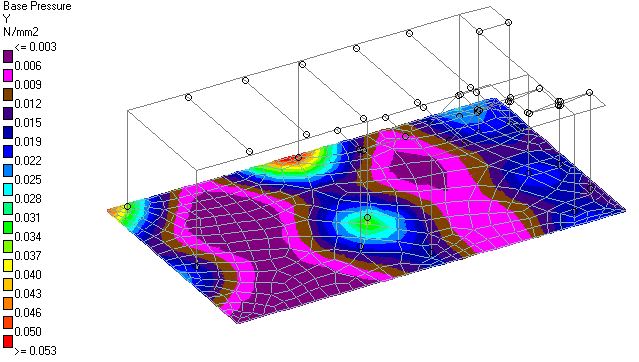

The 1st option is directly connect the new column to the 200mm thick slab. therefore I check the slab for punching (300KN:ultimate load) and soil bearing capacity (120kpa)(see model)
as per this analysis the 200mm thick slab is safe. or do I miss something?
And when I submit the calculation, The municipality engr suggest this kind of this detail (1200x1200x300mm footing with dowel). I was confuse of the footing size 1200x1200 because the maximum axial force is (200kn:service load) which will fail on Soil bearing 140kpa>120kpa and at that time I thought that dowel is to spread the load coming from the column to satisfy the soil bearing capacity.
