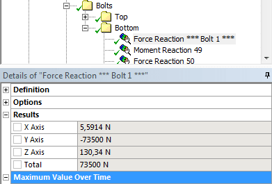

We have models with bolts that are split and have bonded connections at desired cross sections. Normally we insert force and moment reaction probes for each connection, then make a plot and copy paste from this to Excel to process the data further. If possible we'd like to get these values using a command block to minimize the setup work and hopefully minimize the risk of possible errors in the extraction.

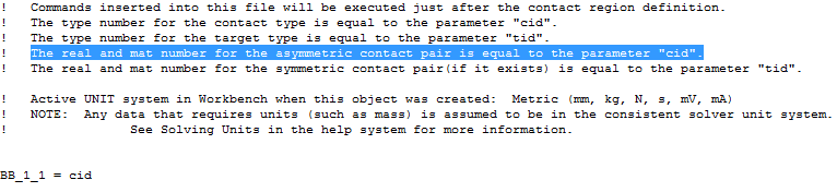

So far I've added a command block at each connection to get a meaningful definition to identify them. The code follows the following definition:
Code:
BB_1_1 = _cid

I've done the setup exactly as you show, but I'm not able to reference the cid by the name created in the command at the contact (BB_1_1). I know the my value is very small, but there's a relative difference of >200%. I see similar varying accuracy in the moments from my calculations (see further down). As moments can only be extracted in the underlying elements, I asked for a way to do this in the script too, to check if the extracted values are identical then.
Could the inability to reference the name created at the contact be a result of our Workbench setup? We set up our model (connections and mesh) in one system and then connect this to other systems where we setup load case specific connections and loads. I've tried adding the commands at the connections in the first system (Mechanical Model), but these are not imported to the second system (script).
I thought the ID was specific to each contact. I simply went into the Solver Output and found the contact creation
As I see it from the command inserted at the connection, the real constant should equal the contact ID
Hence, it seems to me, that BB_1_1 = cid (= 159).
Left image is results from script using esel, s, type,, BB_1_1.                     Right image is results from script using esel, s, type,, 159.
Left image is force results from probe at Contact (Underlying Element).        Right image is moment results from probe at Contact (Underlying Element).

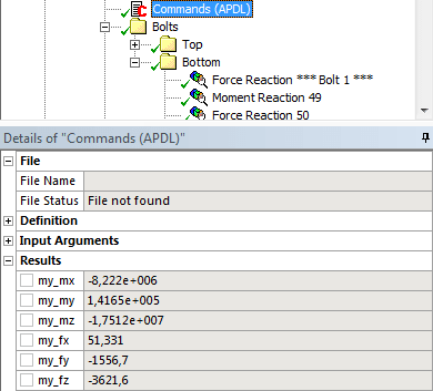

The file status for the script says File not found. What does this mean? I haven't been able to find anything searching online and in the manual.
Could there be some setting that I have not set properly in Mechanical to make it possible to use the script at the contact?
Hi Dixib,
The *GET forces and moments from my script matches well with WB probe so the general framework should be correct.
The named selections should go through.
OP said:
Could there be some setting that I have not...
It's hard to troubleshoot your model from afar. Try starting with a simple model, make sure that works and build up complexity to troubleshoot.
