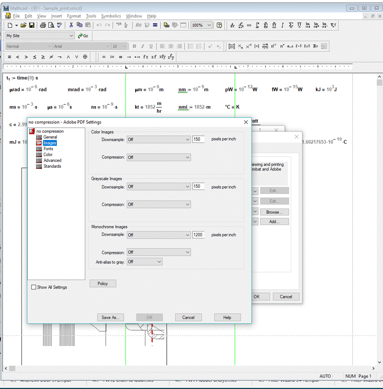

Hello,
The images on my MathCAD sheet get blurred when I convert it to a pdf document using the print option. Software used is PDFCreator 2.0. Is there a way to improve the quality?

Can you upload the actual Mathcad file?
I've printed both "Microsoft print to PDF" and Acrobat, and I don't see the image compression artifacts that show up in your images.
TTFN (ta ta for now)
Don't know about PDFCreator, but Acrobat has a bunch of options available for PDF quality. Since the OP didn't provide the original Mathcad file, I cut out the Snippet example, pasted that into Mathcad, and printed with all compression turned off. The results are essentially like the Snippet example. BUT, the file size can be substantially larger than the compression artifacted one.

I can't remember exactly what I did, but this should work
> Print to Adobe PDF
> Click the Properties box for Adobe PDF when it shows up:
> Edit the Default Settings and click on Images:
> Turn off all the compression and save the settings as desired:
