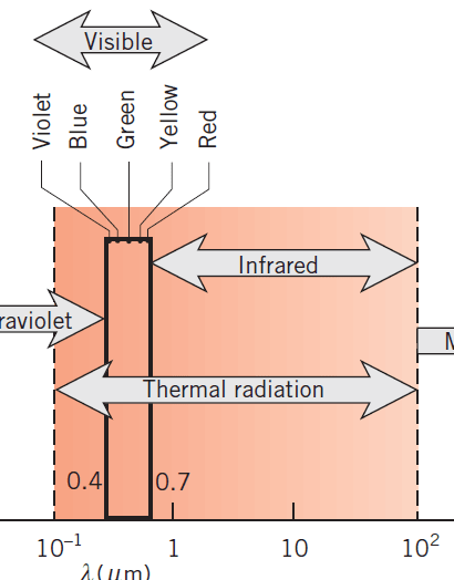

IRstuff,
You are focused on IR and may not be giving due attention to Visible Light (from which color is derived) as another important contributor to thermal radiation and radiation heat transfer.
How an IR thermal sensor works does not correlate directly to how "radiation heat transfer" works.
The following is a useful experiment:
Cheers, hatsegal
