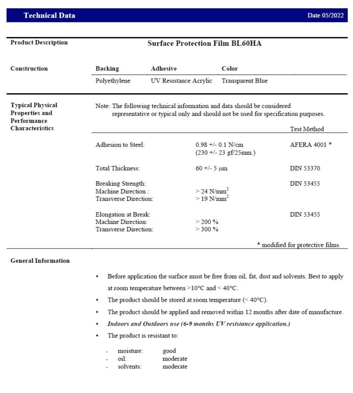

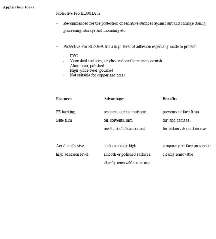

Below is one of barrier I could think of. But this is made of polyethylene. Would it be safe to use on such painted surface?
I would suspect the foaming agent of dissolving the paint. Usually I have seen problems with penetration and damage by plasticizers, but you need more information from your paint supplier and the foam supplier.
When you say the paint is fully cured that typically implies full mechanical strength. However, the paint also has a recoat interval, typically 30 days for a polyurethane. During this time the paint still open to cross-linking.
Dissimilar materials are less likely to cross-link. Polyethylene is dissimilar from polyurethane and also has low surface energy which means it doesn't tend to bond to other materials. FEP performs even better.
