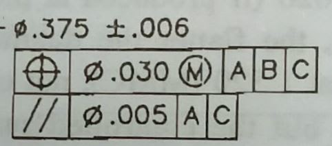

Hai All,
In the drg, the Hole is Located using Position Tolerance 0.010 at MMC, which is stationary.
Next, the Hole Axis will have to Orient and Float at 0.002 but within 0.010 at MMC.
My Question is, Why we need a Parallelism tolerance here & any purpose?
If the Hole Axis will have to Orient and Float at 0.002 but within 0.010 at MMC. How they will Measure the Axis of hole is within 0.002?
Kindly resolve Please.
 https://files.engineering.com/getfile.aspx?folder=ef3f2bc1-9884-481c-a0ce-ad387bd5011e&file=IMG_20201021_163304.jpg

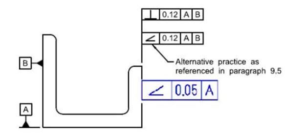

Belanger said:
Are you thinking that it can't twist in that manner? Or are you concerned about datum A appearing in both FCFs?
I am thinking that one (smaller angularity in blue) is overriding the other(bigger angularity in black).
How you can take full advantage of the higher angularity tolerance if the smaller angularity tolerance is already in place?
Because the larger one controls parallelism to the second datum feature simulator and the second one does not.
Yes, I do understand that, but my main questions about the physical realities of such callout remains largely unanswered.
Again, the questions are copied below:
"I am thinking that one (smaller angularity in blue) is overriding the other(bigger angularity in black).
How you can take full advantage of the higher angularity tolerance if the smaller angularity tolerance is already in place?"
Draw the top view. You'll see a wider zone controlled by the first FCF than is controlled by the second one.
greenimi,
Imagine the considered surface from your posted figure produced as flat as possible, at "exactly" 90° relative to datum A, and at 2° degrees relative to datum B. This one would utilize about zero of the 0.05 tolerance zone of angularity relative to A, but (depending on how large that surface is) the 2° slant could possibly use the entire 0.12 tolerance zone of angularity relative to the DRF established from |A|B|. It could as well deviate outside of the 0.12 tolerance zone and the part could be rejected.
Thank you. Let me digest that. Appreciate your help
Hai All,
I also have the doubt from greenimi,
As from drg, 1. Angularity with [A] & 2. Perpendicularity [A]B] using the surface here is 90deg.
What can be the designer intend, to keep 2 Callout for a single surface?
Can be 1. for a operation & 2. for next operation ?
Any wrong in Question, pl. dont mistake.
Thanks.

Anbu Saravanan,
The reason that a designer may want to specify both callouts is that they don't mean the same thing, and both needed. Angularity to A controls only orientation to datum A. There is no datum B for this control and the orientation to datum feature B as far as this control is concerned can be anything. Even 45°, despite being shown parallel on the drawing. The perpendicular orientation to A must be held within 0.05.
On the other hand perpendicularity or angularity with reference to |A|B| controls orientation to both datums. Because datum feature A is referenced as primary it has a closer relationship with the true geometric counterpart that establishes datum A, than the relationship between datum feature B and its true geometric counterpart; datum feature A contacts the true geometric counterpart ar at least 3 points of contact while datum feature B may contact its true geometric counterpart at only 2 points. However, both the perpendicular orientation to datum A and the parallel orientation relative to datum B have to be held simultaneously within 0.12 when the requirement is evaluated.
To riff on Burunduk's recent comment -- think of the 0.12 this way: The designer wants to control angularity to datum B (within a more generous 0.12), while being mindful that the datum which the 0.12 is really measuring from (datum B) won't be fully flush with datum feature B, but may only touch 2 points.

Or - just what I wrote before:
It is useful in the event that the design is more tolerant of variation in what is essentially a parallelism to the secondary datum simulator in the first callout than variation in the perpendicularity to the primary datum feature in the second.

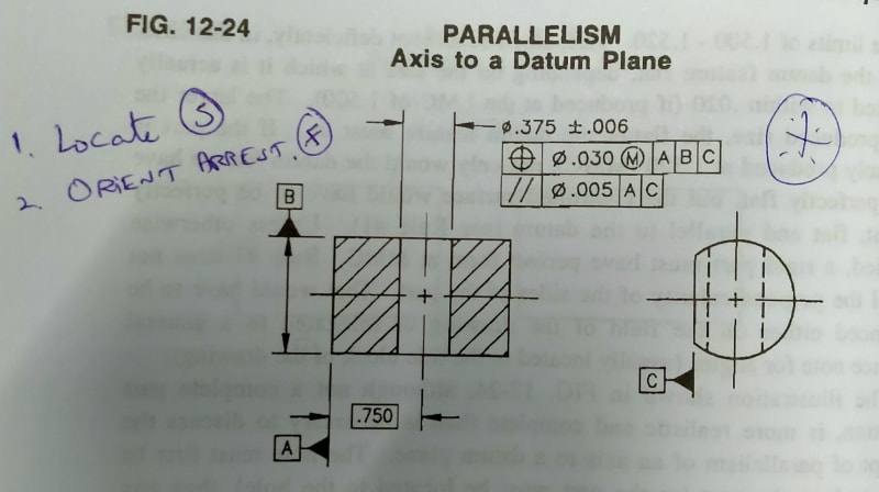

Thanks a Lot Tarator...!!
YES, i had a look at James D.Meadows book, and read
since Secondary datum is specified, the controlled surface is not allowed to rotate about the primary datum axis.
Got cleared with the Orientation doubt and Thanks all...!!

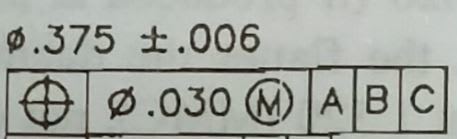

Dear Belanger,
For some weeks ago in this ex,
I have a doubt, you said the independent pin that varies from 0.369 to 0.381, is that correct or will be from 0.374 (0.369 + 0.005) to 0.386 (0.381 + 0.005).
With Regards,
N.Anbu Saravanan.
The .369 to .381 is correct because the pin in question is just simulating the actual hole, even if it's tilted. The GD&T number is not factored into that.
However, if the parallelism callout contained the MMC modifier, then we could speak of a gage pin that is designed to include the .005. That would be what's called a "virtual condition" pin, which would be exactly parallel to datum A.
So again, because this parallelism does not have MMC, we stick with the expanding pin of .369 to .381, which would then itself be assessed for any parallelism error.

ANBU SARAVANAN, in case you wish to clear your doubt further by looking it up in the standard, the pin expanding from .369 to .381 described by Belanger simulates what is referred to as the Unrelated Actual Mating Envelope, and the axis of this envelope is considered as the axis of the cylindrical feature of size for orientation or position control.
Thanks Belanger & Burunduk,
Still a small doubt,
if we take the 1st segment of callout,
Hole at MMC,
0.369 + 0.030 (Bonus Tolerance) = 0.399
0.370 + 0.031 (Bonus Tolerance) = 0.401
0.381 + 0.042 (Bonus Tolerance) = 0.423.
V.C = 0.369 - 0.030 = 0.339
I want to know that, now the Hole is just positioned or Manufactured?
If manufactured how the Parallelism refinement will take effect?
Since the 2nd segment is RFS, we check the Hole by using expanding pin of 0.369 to 0.381,
Just want to know in Manufacturing aspect of thinking.
Could be useful if we could know step by step process in a Hole making process using the above callout.
Thanks all.
