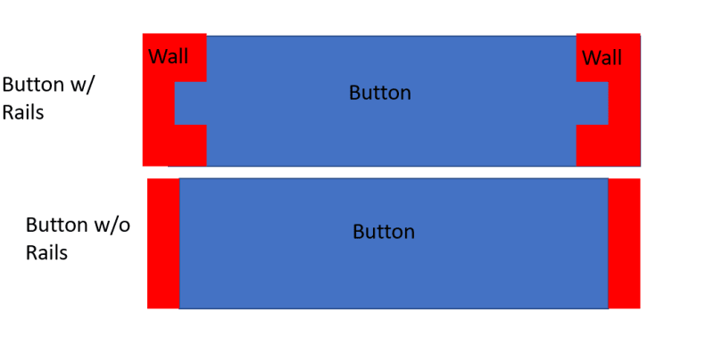

Let's say i'm designing a rectangular button with these two different cross sections. The button is constrained on the left and right by a vertical wall and supported on the bottom by a spring directly below the CG. The only difference between options 1 and 2 is length l.
Three questions:
1. If a force is applied off center, why is option 2 more prone to "jamming"?
2. Why can be done geometrically to reduce likelihood of jamming?
3. What if the button was a cylinder instead of a rectangle, would that help and if so, why?
[URL unfurl="true"]https://res.cloudinary.com/engineering-com/image/upload/v1652147076/tips/IMG_2919_brvepq.heic[/url]
add some guide rails on the inside of the receptacle, and grooves on the outer faces of the button, to encourage the button to translate.
it should be obvious why the wider button would be more inclined to jam, to "cock" in the receptacle (because the push force can more easily not be aligned with the spring)
I don't understand why these guides would help. From a top view, is this what you mean? I don't get how the rails would be better than a button of the same width, can you please explain?

Many buttons have a cylindrical post in the center to reduce binding. In the images the guides would be added to the centers of the top and bottom (wide) faces to reduce the chance of binding.
A 15° chamfer is way better than a 45° chamfer for assembly etc.
"Broken" corners/edges/transitions are required of course.
A little more complicated "cam ground" button approaching/approximating 3DDave's radiused profile might not be necessary.
Counterboring the button on the spring side might allow lengthening the button to a more L/D ratio. 2/1 is a decent starting point.
