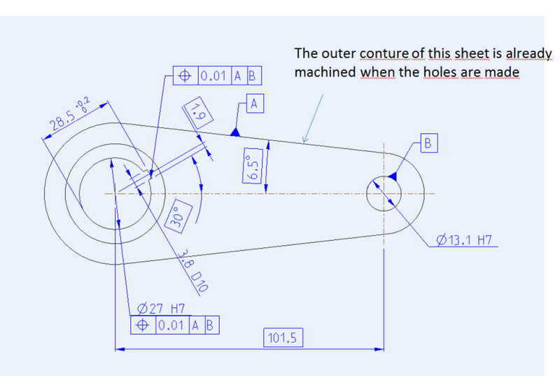

I need some good tips :). I don't know where i shall place the datum features in this drawing see picture below, since i dont have three surfaces normal to each other. I am using the iso standard.
I need to put a concentric tolerance between the holes. On the big hole i need to add a tolerance on the track inside the hole for a parallell key. And a toerance for the track that goes through the hole.
If there is anything i need to clarify just ask. It would been much easier if i could add a datum features on the center line, but the iso standard wont allow it.

I want the holes to be parallell not concentric, my mistake. The way it will be used, is that i will have two round bars through the hole. In the big hole there is a track for a parallell key
Yes i can put the datum feature in the hole. But i would get an axis not a plane and i need to add an angel on the placement of the tracks on the big hole?
A suggestion see picture below

Will anything touch the outer profile or either flat face? Or is it only constrained by (touching) these bars - ie: allowed to float along the bar axes?
This is a topic which comes up quite a bit. The actual theoretical geometry (points/axes/planes) created is not important - what is important is the degrees of freedom which your datum features constrain. This should also be driven by function - I see in your sketch you've noted the outside profile (actually only one segment - I don't think unless its attached to an all-around/between profile tolerance that we assume it applies to anything than the surface it is applied to) as datum feature A because the outer profile is already machined before the holes are. If the only thing which contacts the part is the bars through the 2x holes, then these should be your datum features, regardless of how the part is produced/processed during manufacturing.
The manufacturing process needs to be capable to produce the part to print so it satisfies the design requirements, not the other way around.
That being said, judging by the word "sheet" in your sketch and a general hunch - I assume this part is relatively thin, although you have not shown a side view or thickness. If this is the case, in order to inspect and simulate it repeatably and to prevent allowing excessive angularity error, it would be recommended that one of the flat faces is primary (A), each of the holes your secondary (B) and tertiary (C). If one of the holes is more important or perhaps has a tighter fit, it can be referenced |A|B|C| or if neither hole does it can be |A|B-C|. If they are instead referenced at MMB (or the ISO equivalent) either scheme will result in the same simulator behavior and either can be used.
Actually, I noticed you said "In the big hole there is a track for a parallell key". It is possible that the keyway could instead be your tertiary datum feature - its up to you whether its more important that the keyway be oriented to the holes, or one of the holes oriented to the keyway.
To add to what was said, one of the datum features for the position control on the keyway should be the large hole. It probably should be a secondary datum feature, like chez311 said one of the flat faces should be the primary if it's functional. Your key is going to be assembled in the slot on the shaft that fits in that same hole. If you want the key and keyway to fit, the keyway must be positioned relative to the hole. Also, remove the basic 1.9 - centering of the center plane of the keyway and the axis of the hole is implied.
