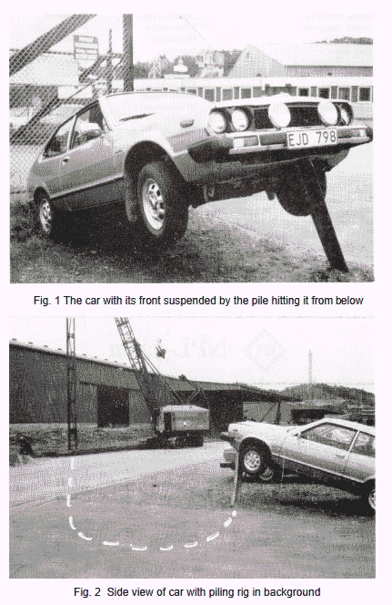

However there are other soil conditions (such as deep layer of hard rock) where H-pile tip bearing can be essentially "infinite"...
"What Goes Down Comes Up - Sometimes" Bengt H. Fellenius

I prefer the term 'really big', myself.
About 40 years back, my wife and I were looking for a new stove. We were approached by a salesman who informed us that the stove we were looking at had infinite temperature control. He was puzzled when I informed him that if I lived forever, I might not be able to appreciate that feature.
