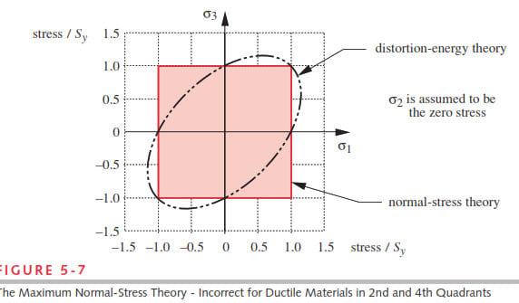

The basic problem is: how do you use simple 1D test data (e.g. uniaxal tension, pure shear) to predict failure of real parts that are exposed to combined states of stress, possibly in 3D. Von Mises and Principal Stresses are one way to do that.
Since the VM stress is by definition a positive number, engineers often prefer to use principal stresses, because failure modes and strength values can be very different in tension and compression and the principal stresses can be positive or negative.

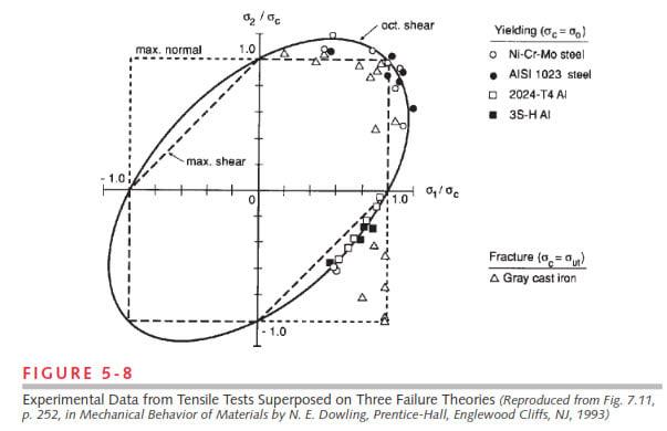

At the end of the day these are just failure theories we attempt to correlate to test data. Reading a machine design book chapter on static failure theories will tell you a lot. I recommend Machine Design: An Integrated Approach by Robert Norton.
The most "accurate" failure theory, or which is conservative, depends on the actual state of stress.
As I've said before on these forums (you can probably find a lot of posts about this exact topic if you search) - von Mises equivalent stress is just an equivalent uniaxial stress magnitude that causes the same shear distortion strain energy as the actual applied stress state, meant to be used with a typical uniaxial stress strain curve. The area below a typical stress strain curve represents the total strain energy absorbed. But we may recognize that the hydrostatic component of the strain energy contributes basically nothing to failure.
Actually the theory comes from Maxwell, Huber, Hencky, and von Mises independently.
The whole crux of what the various authors contribute is to take advantage of the fact that the second main invariant of the deviatoric stress tensor is always positive and can be assessed as a scalar value.
The theory is that the shear distortion strain energy (deviatoric strain energy) associated with change in shape of a stress element is key to material failure. The hydrostatic component contributes essentially nothing to failure. (And this is borne out by test data)
As such, for a complex stress state, we want a method of comparing deviatoric strain energy per unit volume to an imposed yield value. Von Mises “stress” does indeed have units of stress (intentionally) but is perhaps more rightly thought of as distortion strain energy per unit volume.
