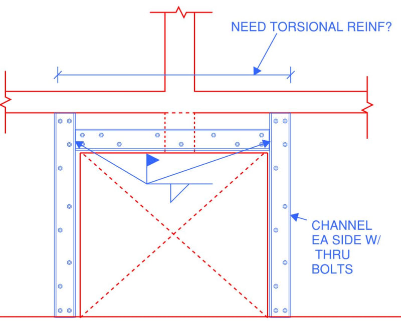

I'm trying to come up with some reinforcing (still preliminary, having calculated loads yet), and this is what I have. I know this would put the "beam" in torsion, so I might need to reinforce that. But IDK if i'm making a mountain out of a mole hill or what. If I could get any criticism on the reinforcing that'd be great. Thanks!
- How thick is the existing wall?
- Do we know enough about the wall reinforcing that we could make a play for analyzing the wall with no reinforcing? Or are we stuck with a do no harm approach?
- I don't see the channel doing much of anything that the exiting girt thing couldn't do better.
- Any torsion headed for the beam will get drawn into bending in the wall above. So I wouldn't bother with torsional beam reinforcement.
- If the approach is "as good as it was", then I think that something is lost in the channels not being flexurally continuous with the column remnant above. That's probably what your thinking was with the beam torsion.
- A very simple solution if you can sell it might be to add a WF column either side of the opening that runs the full height of the wall. Place it outboard of the girt thing and tie back to the wall with some threaded rods for spacers.

12", 22' tall. . The concrete column is 15" wide, 34" deep. (Protrudes past the wall 11" on either side). The column being so large is what's making me want to err on the side of safety and caution. Did the original designer see something I'm not? Just seems massive for out of plane wall support.

No as-builts on this one. Doing a no harm approach.
Yeah, I see that now. Something about reinforcing each side made me more comfortable at the time.
Yeah that was my thinking. I was envisioning the wall as a "floor", with the column being a "girder" that picked up the beam. Cutting one half of the column off, and putting it's replacement transversely offset is relying on torsion in the beam to transfer the flexure.
That's a good solution. I just feel weird not directly reinforcing the column.

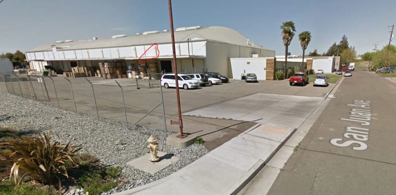

I haven't been to the site yet (it's 1.5 hours away). Looking on google maps I might have made a realization as to why these columns are so large. I think that this interior wall might have been exterior as CANPRO stated. Exterior, AND previously supported an awning as shown below. This picture is of the exterior wall perpendicular to the interior wall I'm analyzing. The architect is visiting the site tomorrow, hopefully I'll get enough information out of him to make a judgement call.
I agree, the canopy explanation looks pretty promising. Ockam's razor and all. 12" seems like a thick wall to need all that stiffening, even at 22' height.

That system was fairly common in Florida with larger commercial building exterior walls (one-story), guessing before 1970 or so. The CMU is usually unreinforced, so the concrete "frame" is there for out-of-plane wind and seismic. That had to be an exterior wall as others have said.
Our approach would usually be sawcut the face of the CMU and add vertical reinforcing to your jambs and solid grout them. That concrete beam is probably fine spanning that but you don't have as-builts. I would move your channel up to the beam for a very conservative approach, gives you solid concrete to epoxy bolt into, and then sawcut and remove all of the CMU below that concrete. Fill in that space between the top of the door and the beam with metal stud or wood framing.
