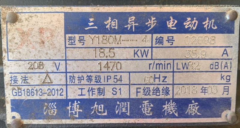

I have a motor with a nameplate rating of:
Delta
36.6A
18.5kW

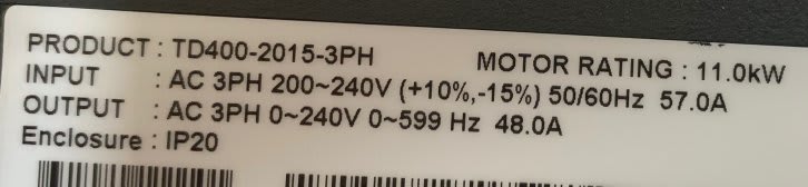

I grab a drive rated at 57A.
It shows up and the nameplate states:
Input: 200~240V 57.0A
Output: 0~240V 48.0A
Motor Rating: 11.0kW
This misses the mark by 7.5kW. What am I missing?

Finally got a picture. No sign of 400V operation.

The problem is deciding which part of the erroneous nameplate to believe. Is it a 208V motor requiring >70A to run or is it a 36A motor requiring >400V to run? The amp rating is actually closer to what you expect from a 460V motor than the 380V rating that you would expect from a dual voltage wye/delta motor having 208V as the low voltage. Having said that, is it really an 18.5kW motor?
Also, I will point out that the rated speed of 1470 rpm is pretty low for a 60Hz motor. Is it a Design C or D motor having very high slip or is it a 50hz motor? This is the problem, once you decide the nameplate is erroneous, which part can you believe, if any?
That is the crux of it, not knowing where the mistake is.
Looks as though the 18.5kW is correct though. The “Y180M...” comes up as a Chinese 18.5kW 380V 1470RPM motor, “or any voltage between 220 - 760V, 50/60 Hz”. Yeah...
Click on the “Show more” link.
So to finish that thought;
If it were me, I would tell them that given the obvious error(s) on the nameplate, you are going to assume the 208V and 18.5kW are correct, and only the FLA is wrong. Then treat it as a 25HP 208V motor with the VFD sized accordingly.
But warn them that IF the FLA was correct and they mislabeled the kW (ie its a 7.5kW motor with really poor efficiency), the motor may burn up before the OL trips in the VFD, at which time they can replace that toy motor with a real one made by someone who knows what they are doing.
The 180M frame tallies with it being a 4-pole 18.5kW 50Hz machine.
A 2-pole design in that frame would be a 22kW machine, an 18.5kW 2-pole would be on a 160L frame and a 6-pole would be on a 200L frame.
If you can start it, measure the magnetising current when it's running open shaft - should be around 40%-50% of FLC at rated voltage. If it's way below that value then the chances are it's a higher voltage machine.
jraef, your link is a good find and it does give us some clues. It appears that the kW rating, current, and speed are based on the 380V, 50Hz power supply. It is the nameplate voltage and frequency that do not match. Interestingly enough, the voltage and frequency stamps are a smaller typeset, suggesting that perhaps the motor is custom designed for 208V/60hz. This suggests the practice of pre-stamping the nameplate with kW, amperage, and speed and leaving the voltage and frequency to be stamped based on the custom voltage and frequency values. This is, of course, a shoddy practice. However, if true, this suggests that the motor rating would actually be 208V, about 62-65A, and about 1780 rpm.

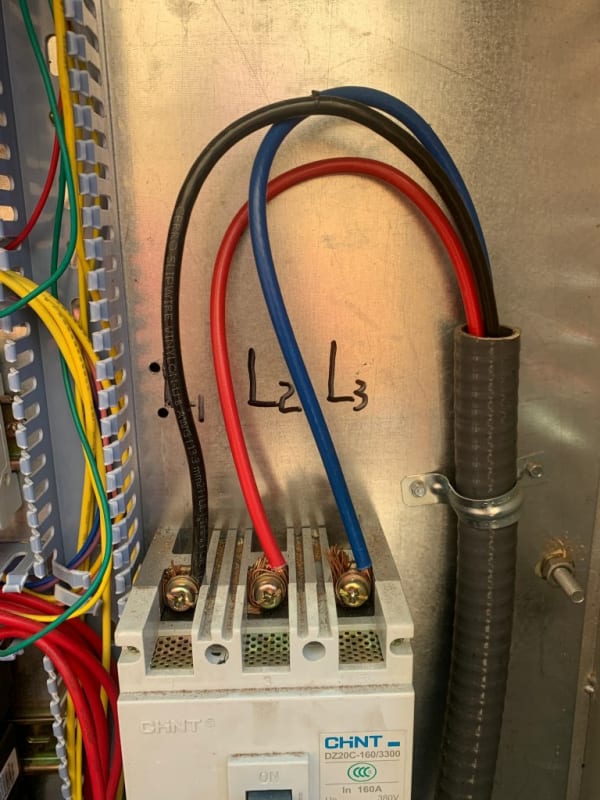

Big wire to breaker: AWG 6
Measured here: (Hey! That's a 60A breaker. Not equating well with a +70A requirement of a 208V 25hp motor..)

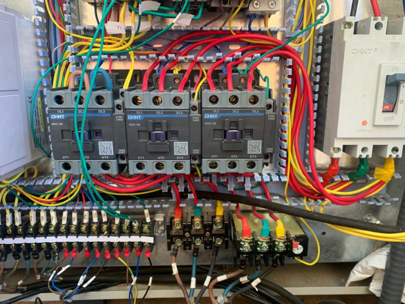

In this panel. Note the Star/Delta starter.

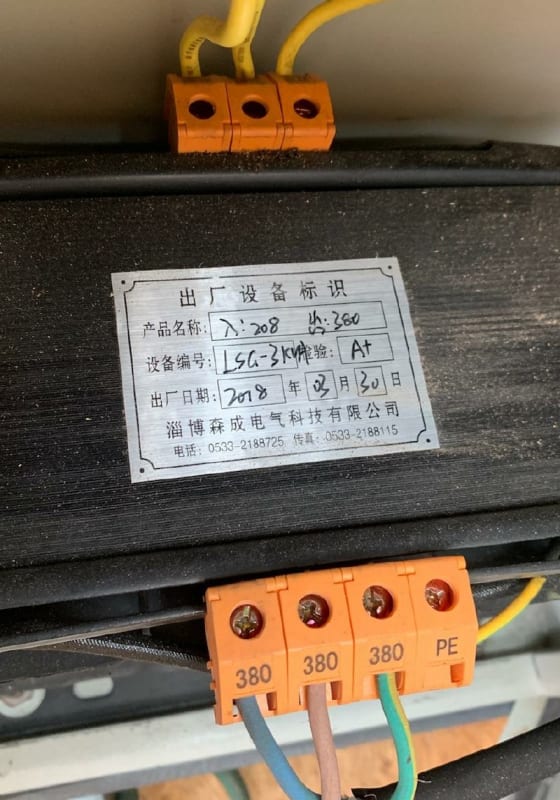

And just for you rhatcher:
Which makes me wonder what the 380V is being used for?

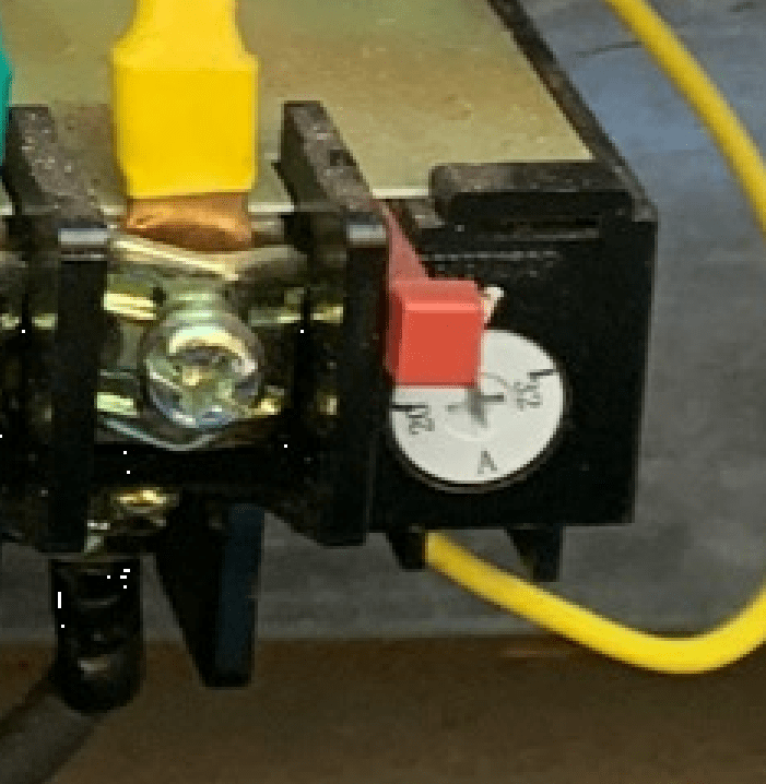

What is that OL relay set for? Whatever it says will be 57% of the motor FLA (or should be, but coming from a place that can’t label the motor correctly, who knows).

This is pretty perplexing. I can't make sense of the markings on the CPT. I would have guessed it was meant for 380V/208V step-down service but who knows. Is it actually stepping the 208V up to 380V and, if so, what is the 380V feeding? You should put a meter on it, perhaps it is stepping the 208V down to 114V which is 'close enough' to run 120V contactor coils.
The NLA amps that you recorded suggest the FLA is in the ballpark of what is predicted for the 18.5kW motor running at 208V. Also, the label on the breaker states In = 160A, not 60A. Why the breaker is this large is a mystery but this explains why it has not tripped [smile]. Jeff's suggestion of checking the overload rating is s good one, LPS for him. However, if they selected the OL's the same way that they selected the breaker you won't gain any insight from this.

rhatcher; That is a 208 step-up to 380V to run part of the system. Just proving your point that the original system is indeed a 380V system. I also see your point about the 114Vac angle.
I saw the In-160 rating but the client states that the breaker is a 60A unit and we can't see the breaker handle in any picture. I'm guessing the In-160 is perhaps a model number or frame size?
He has no interest in running the saw slower, the VFD is simply to allow frequent starts. It was considerably less money than a soft starter that only allowed 5 starts an hour. He often has to stop the saw to make adjustments between each cut. The star-delta is dying and he hates it. As for the overload its setting should set the motor current with a stake-in-the-ground because it's never tripped at it's dial setting.
Isn't it wonderful how they feed the breaker AWG 6 THHN and then feed the delta contactor AWG 8 (55A @ 90C) for a so-called 18.5kW motor?

I'm not clear on why the overloads would be set to 57% of FLA. So, for the moment, if I don't know why, I'm gonna bet the Chinese sure don't.
32A-20A = 12A
Estimating that the dial is about 70% of that 12A = 8A
20A + 8A = 28A
Remember 208V.
Well if that don't beat all..
A 28A 208V motor is less than 10HP!! What a rip-off.
Explains why the AWG 8 hasn't charred black.
It's looking like the VFD we have will actually work since a 10HP motor is a 7.5kW motor and the drive we have is an 11kW Drive. (I'll throttle back the overload setting.)
So if the 57% doesn't come back and bite us the uncharred wire and the (100%) overload setting all make this look like a 10hp motor regardless of its 18kW frame.
