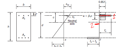

So, there is a serious problem if the steel fixer by mistake instead of installing the compression rebars at d' = 2, he installed at 3.5. Am I right???

Yes, the concept is marginal. You have 3" of compression concrete, ~1.5" of that is cover meaning the reinforcement has to be in its exact design position to act as intended. The negative value of f's when d'=3.5" means it is in tension and doing virtually nothing for your capacity. Having the reinforcement position wrong by 1.5" in a 12" beam is a big miss and should be rejected, but it's still too tight a tolerance to be safe in my opinion.
Basically, doubly-reinforced design in such a shallow beam isn't practical, especially when relying on it for 60% of the total capacity.

To illustrate, a bar placed (as intended?) at 2" depth (#1) and at 3.5" depth (#2) behave fundamentally differently. Bar #1 is in compression, Bar #2 is in tension.
So, yes, on the analysis side, a beam with top bars at #2 would be analyzed as a singly-reinforced beam section (as you've noted, with very little strain/stress/resultant capacity in the top bars). Additional tensile steel could be added to make the beam work as singly-reinforced, steel at position #1 could be added to return to doubly-reinforced behavior, or beam dimensions could be increased.
If this is a beam which has already been poured -- I agree, that's a significant mistake by the inspector and contractor. It needs to be fixed (at contractor expense), whether that means breaking it out and pouring again, or perhaps some sort of external strengthening like a composite wrap would be an option.

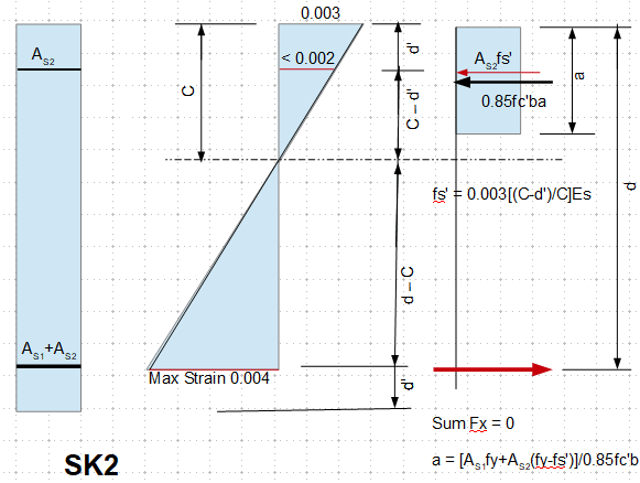

XinLok,
Strain and stress diagrams are the best tools for reinforced concrete design. From which you can easily visualize the behaviors of a given cross section with regards to the changes in design parameters. Sketches below show the case with both steel have yield (SK1), and the case with tension steel has reached the maximum strain limit. Have fun.
Note the strain limit on SK2 corresponding to the maximum amount of reinforcing (AstMAX) of the cross section, under which (AstMAX) the cross section is considered "under-reinforced". Depending on the version of code, the strain limit can be set as 0.005 (Under -reinforced - tension steel strain > 0.005.)
